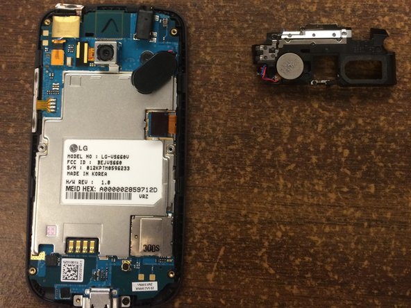

  6. LG Vortex Rear Facing Camera Replacement, Rear Facing Camera: crwdns2935265:06crwdnd2935265:01crwdnd2935265:03crwdne2935265:0 LG Vortex Rear Facing Camera Replacement, Rear Facing Camera: crwdns2935265:06crwdnd2935265:02crwdnd2935265:03crwdne2935265:0 LG Vortex Rear Facing Camera Replacement, Rear Facing Camera: crwdns2935265:06crwdnd2935265:03crwdnd2935265:03crwdne2935265:0
    • NOTE: This is the most difficult step.
    • Identify the system board (the main circuit board) inside, and locate the camera module area at the top.
    • You’ll see a black plastic component around the camera that’s seated on (but is not soldered to) the system board.
    • On each side of that black plastic piece, there are 2 black tabs securing it to the board. Gently pry these tabs outward (away from the board).
    • Hold them off the board, because they may snap back if released.
    • This is one of the trickiest areas — proceed slowly.

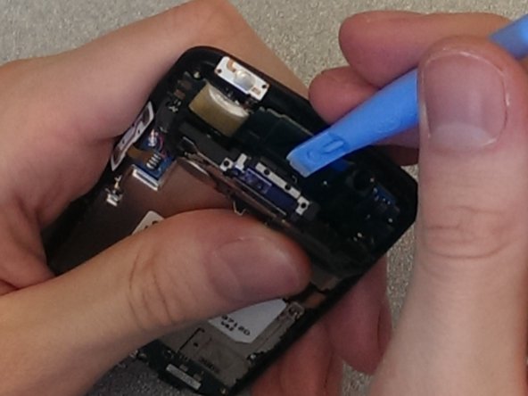

  7. LG Vortex Rear Facing Camera Replacement: crwdns2935265:07crwdnd2935265:01crwdnd2935265:01crwdne2935265:0
    • Using the blue plastic prying tool remove the black piece next to the camera.
    • Do not damage the thin wires attaching the motherboard to the speakers

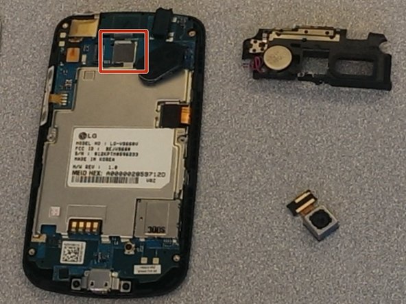

  8. LG Vortex Rear Facing Camera Replacement: crwdns2935265:08crwdnd2935265:01crwdnd2935265:01crwdne2935265:0
    • Remove with caution.
    • Disconnect the cord attaching the camera to the system board.
    • Once the tabs are held back, use a prying tool to lift the black housing—the piece that holds the camera—away from the system board.
    • Work gradually along its edges, making sure not to tug on wiring nearby.

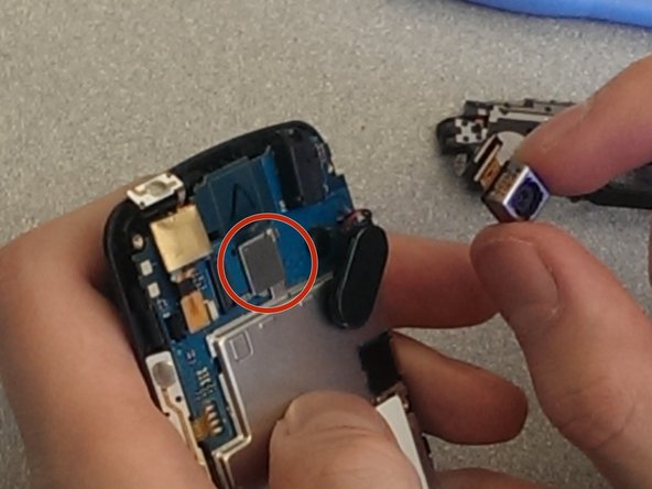

  9. LG Vortex Rear Facing Camera Replacement: crwdns2935265:09crwdnd2935265:01crwdnd2935265:03crwdne2935265:0 LG Vortex Rear Facing Camera Replacement: crwdns2935265:09crwdnd2935265:02crwdnd2935265:03crwdne2935265:0 LG Vortex Rear Facing Camera Replacement: crwdns2935265:09crwdnd2935265:03crwdnd2935265:03crwdne2935265:0
    • The camera module is secured by a small sticker or adhesive tab on its top.
    • Carefully pry this piece away with your fingernail, watching out for thin wires (e.g. wires connecting the board to speakers or other parts).
    • Once the adhesive is loosened, gently lift the camera straight up and off the board.
    • Pull the camera off the system board using your fingers. Perform this step with caution.
  10. LG Vortex Rear Facing Camera Replacement: crwdns2935265:010crwdnd2935265:01crwdnd2935265:01crwdne2935265:0
    • Place the new camera module in the exact orientation and location where the old one sat.
    • Reapply the sticker/adhesive back over the top of the camera (or use new adhesive if supplied).
    • Ensure the camera sits flush and aligned correctly.
  11. LG Vortex Rear Facing Camera Replacement: crwdns2935265:011crwdnd2935265:01crwdnd2935265:01crwdne2935265:0
    • Reverse the steps above to reassemble the phone.
