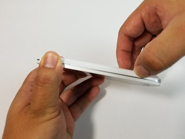

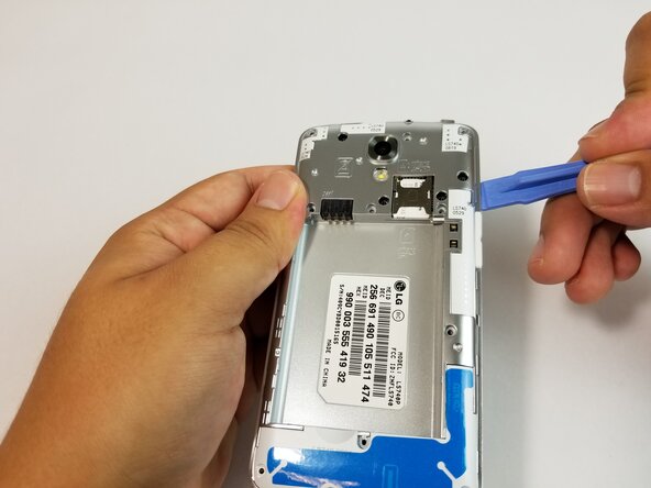

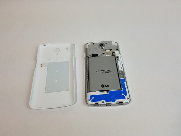

    • Pry back cover with finger in the crease.
    • Remove back casing.

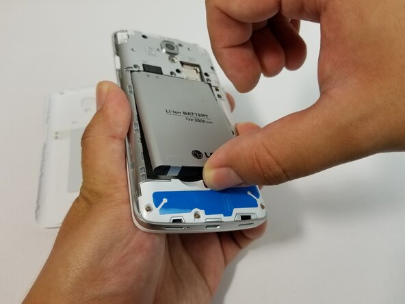

  2. LG Volt Screen Replacement: crwdns2935265:02crwdnd2935265:01crwdnd2935265:03crwdne2935265:0 LG Volt Screen Replacement: crwdns2935265:02crwdnd2935265:02crwdnd2935265:03crwdne2935265:0 LG Volt Screen Replacement: crwdns2935265:02crwdnd2935265:03crwdnd2935265:03crwdne2935265:0
    • With your finger, pry the battery out through the crease made for removal.

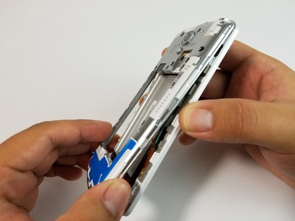

  4. LG Volt Screen Replacement: crwdns2935265:04crwdnd2935265:01crwdnd2935265:03crwdne2935265:0 LG Volt Screen Replacement: crwdns2935265:04crwdnd2935265:02crwdnd2935265:03crwdne2935265:0 LG Volt Screen Replacement: crwdns2935265:04crwdnd2935265:03crwdnd2935265:03crwdne2935265:0
    • Use the plastic opening tool to remove the back housing from the frame of the phone.

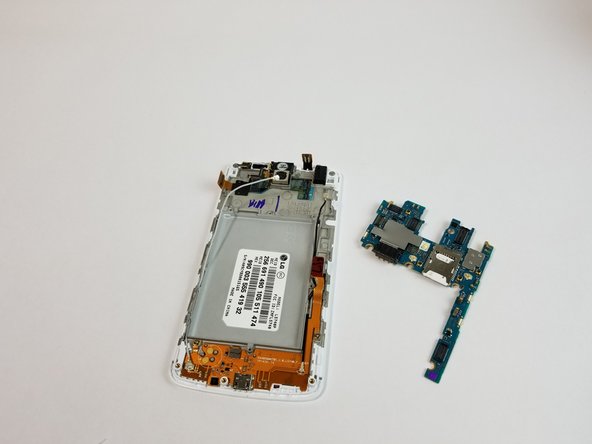

  5. LG Volt Screen Replacement: crwdns2935265:05crwdnd2935265:01crwdnd2935265:02crwdne2935265:0 LG Volt Screen Replacement: crwdns2935265:05crwdnd2935265:02crwdnd2935265:02crwdne2935265:0
    • Carefully lift all the indicated tabs.
    • Carefully unplug the marked cables.
  6. LG Volt Screen Replacement: crwdns2935265:06crwdnd2935265:01crwdnd2935265:02crwdne2935265:0 LG Volt Screen Replacement: crwdns2935265:06crwdnd2935265:02crwdnd2935265:02crwdne2935265:0
    • Remove motherboard carefully.

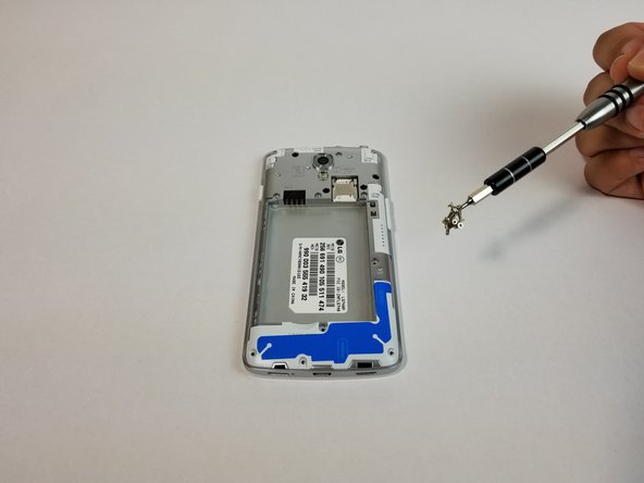

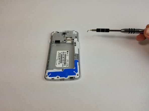

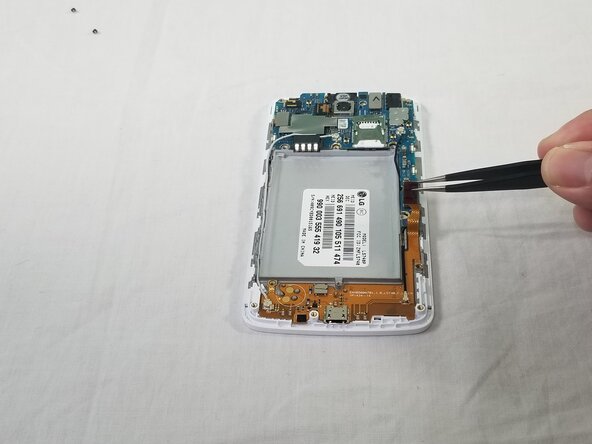

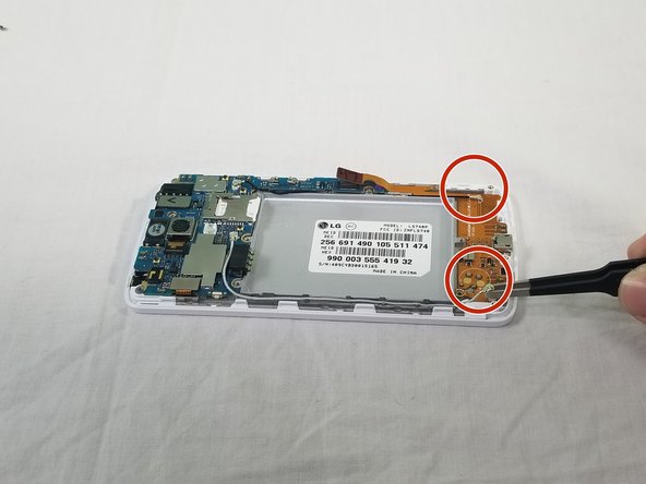

  7. LG Volt Screen Replacement: crwdns2935265:07crwdnd2935265:01crwdnd2935265:01crwdne2935265:0
    • Using the precision tweezers set lift the copper tab located on the right side of the device.

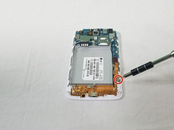

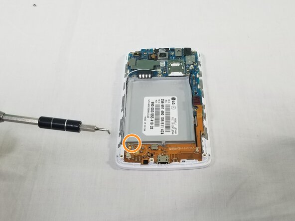

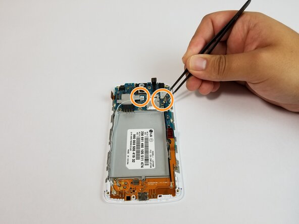

  8. LG Volt Screen Replacement: crwdns2935265:08crwdnd2935265:01crwdnd2935265:02crwdne2935265:0 LG Volt Screen Replacement: crwdns2935265:08crwdnd2935265:02crwdnd2935265:02crwdne2935265:0
    • Using a JIS #000 screwdriver, remove the 1 (4mm) screw on right side under copper tab.
    • Using a JIS #000 screwdriver, remove the 1 (4mm) screw on bottom left under battery tray.

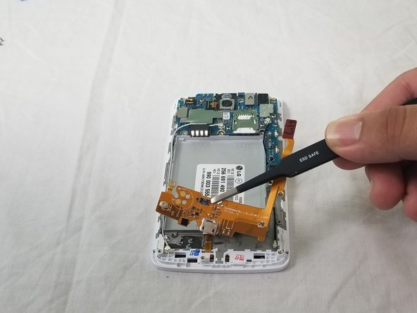

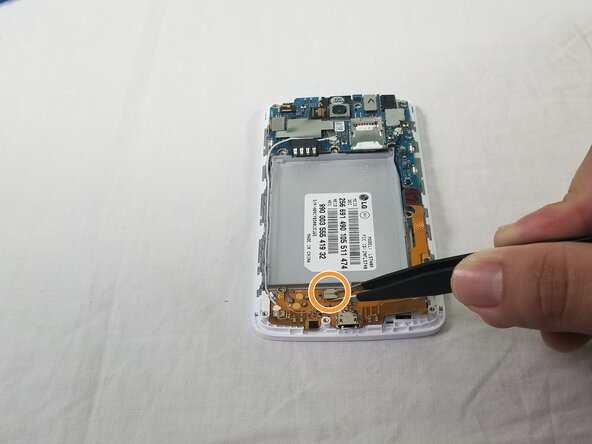

  9. LG Volt Screen Replacement: crwdns2935265:09crwdnd2935265:01crwdnd2935265:03crwdne2935265:0 LG Volt Screen Replacement: crwdns2935265:09crwdnd2935265:02crwdnd2935265:03crwdne2935265:0 LG Volt Screen Replacement: crwdns2935265:09crwdnd2935265:03crwdnd2935265:03crwdne2935265:0
    • Disconnect the white and black cables as indicated using the precision tweezers set.
    • Lift indicated flap as shown.

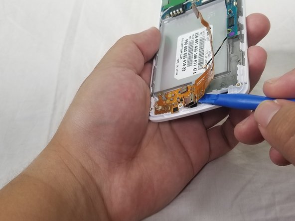

  10. LG Volt Screen Replacement: crwdns2935265:010crwdnd2935265:01crwdnd2935265:03crwdne2935265:0 LG Volt Screen Replacement: crwdns2935265:010crwdnd2935265:02crwdnd2935265:03crwdne2935265:0 LG Volt Screen Replacement: crwdns2935265:010crwdnd2935265:03crwdnd2935265:03crwdne2935265:0
    • Use the plastic opening tool to carefully lift the charger assembly from the phone.
    • Start from the copper tab and continue in a clockwise direction.
    • Once it is loose remove the assembly from the phone.

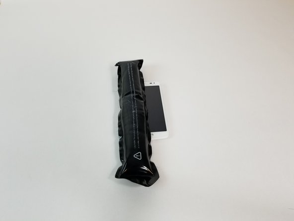

    • Heat up iOpener for 30 seconds in the microwave.
  12. LG Volt Screen Replacement: crwdns2935265:012crwdnd2935265:01crwdnd2935265:02crwdne2935265:0 LG Volt Screen Replacement: crwdns2935265:012crwdnd2935265:02crwdnd2935265:02crwdne2935265:0
    • Place iOpener on right side of the screen with the phone facing up for 90 seconds.
    • If necessary, heat up the iOpener for an additional 30 seconds in the microwave.
    • Place iOpener on left side of the screen with the phone facing up for 90 seconds.

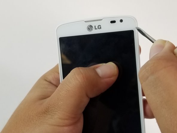

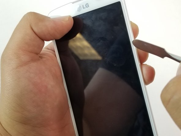

  13. LG Volt Screen Replacement: crwdns2935265:013crwdnd2935265:01crwdnd2935265:03crwdne2935265:0 LG Volt Screen Replacement: crwdns2935265:013crwdnd2935265:02crwdnd2935265:03crwdne2935265:0 LG Volt Screen Replacement: crwdns2935265:013crwdnd2935265:03crwdnd2935265:03crwdne2935265:0
    • Once the phone is hot, use the small, pointy tipped metal spudger to remove the adhesive.
    • Once removed, use the large, flat tipped metal spudger to pry the screen off carefully.
