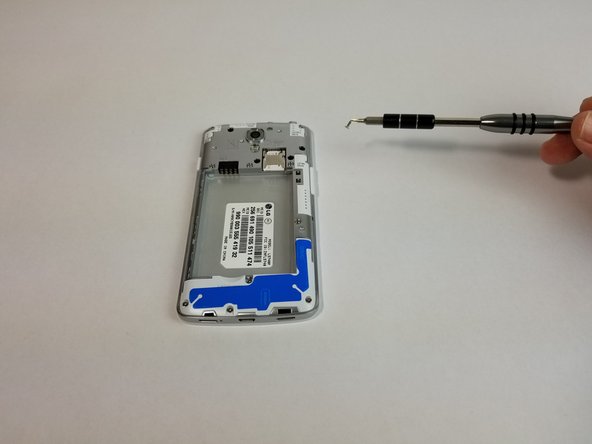

      • With your finger, pry the battery out through the crease made for removal.
    3. LG Volt Power Button Replacement: crwdns2935265:03crwdnd2935265:01crwdnd2935265:03crwdne2935265:0 LG Volt Power Button Replacement: crwdns2935265:03crwdnd2935265:02crwdnd2935265:03crwdne2935265:0 LG Volt Power Button Replacement: crwdns2935265:03crwdnd2935265:03crwdnd2935265:03crwdne2935265:0

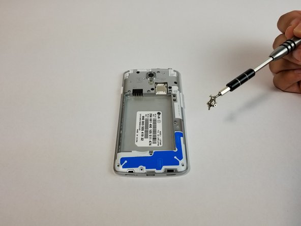

      • Remove all 11 (4mm) screws with the JIS #000 screwdriver
      • There are three screws on top, three above the battery, one next to the battery, one under the battery and three at the bottom of the phone.

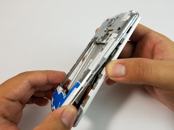

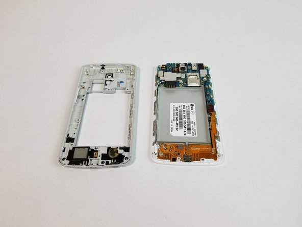

    4. LG Volt Power Button Replacement: crwdns2935265:04crwdnd2935265:01crwdnd2935265:03crwdne2935265:0 LG Volt Power Button Replacement: crwdns2935265:04crwdnd2935265:02crwdnd2935265:03crwdne2935265:0 LG Volt Power Button Replacement: crwdns2935265:04crwdnd2935265:03crwdnd2935265:03crwdne2935265:0
      • Use the plastic opening tool to remove the back housing from the frame of the phone.

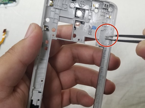

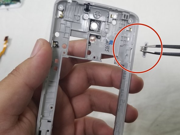

      • Use the precision tweezers set to gently lift the rubber tab off its anchor.
      • Then push the power button through the cutout to remove completely.
