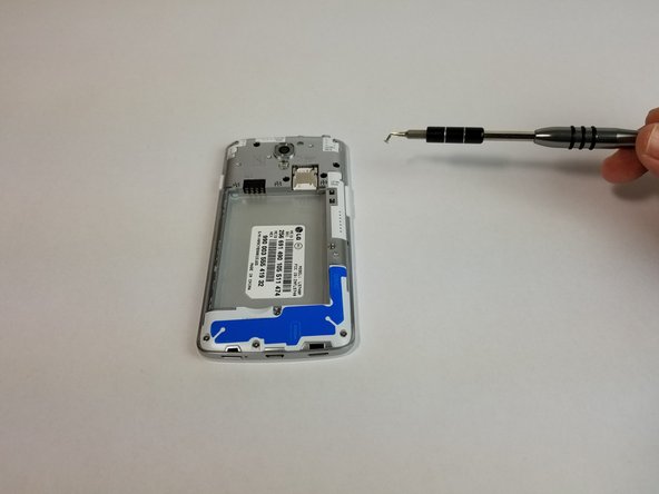

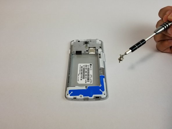

      • Remove all 11 (4mm) screws with the JIS #000 screwdriver
      • There are three screws on top, three above the battery, one next to the battery, one under the battery and three at the bottom of the phone.

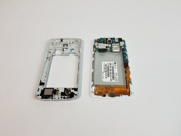

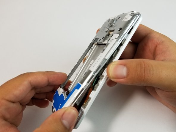

      • Use the plastic opening tool to remove the back housing from the frame of the phone.

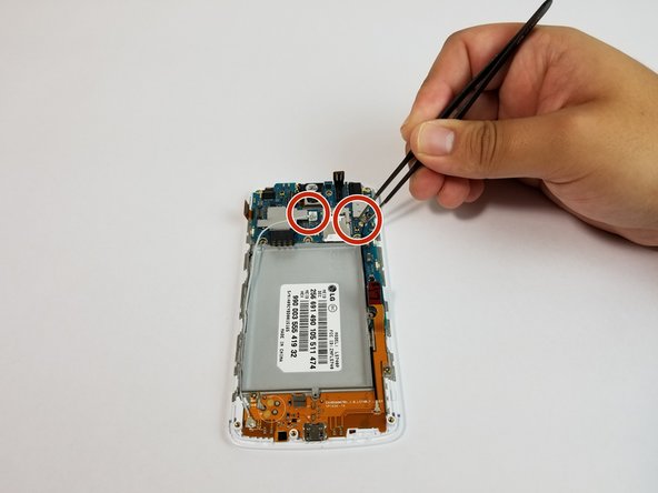

      • Carefully lift all the indicated tabs.
      • Carefully unplug the marked cables.

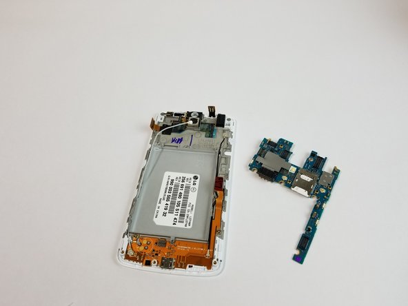

      • Remove motherboard carefully.
    7. LG Volt Motherboard Replacement: crwdns2935265:07crwdnd2935265:01crwdnd2935265:01crwdne2935265:0
      • Put new motherboard in place of old motherboard.
      • Follow steps 6 through 1 in that order for reassembly.
