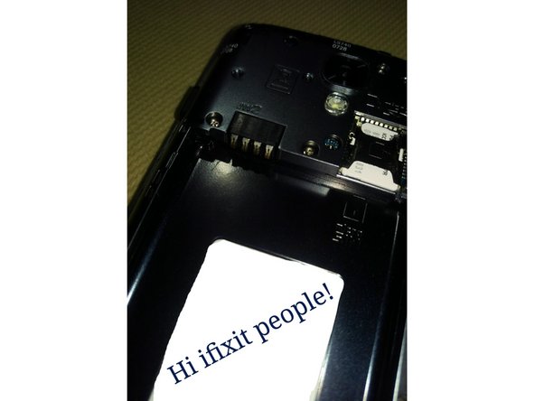

  3. LG Volt LS740 Charging Port Replacement, Remove Battery & Sim Card: crwdns2935265:03crwdnd2935265:01crwdnd2935265:02crwdne2935265:0 LG Volt LS740 Charging Port Replacement, Remove Battery & Sim Card: crwdns2935265:03crwdnd2935265:02crwdnd2935265:02crwdne2935265:0
    • Note the location of the screws to remove the inner rear panel.

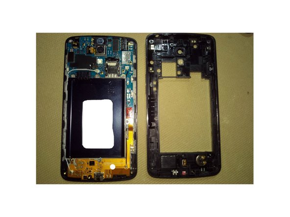

  4. LG Volt LS740 Charging Port Replacement, Remove Inner Rear Cover: crwdns2935265:04crwdnd2935265:01crwdnd2935265:02crwdne2935265:0 LG Volt LS740 Charging Port Replacement, Remove Inner Rear Cover: crwdns2935265:04crwdnd2935265:02crwdnd2935265:02crwdne2935265:0
    • Remove the 11 screws on the inside rear cover using your Phillips screw driver.
    • See photo from "Remove Battery" step for location of screws.
    • Use your pry tool and carefully work your way around the inside rear cover to undo the snaps and remove it.
  5. LG Volt LS740 Charging Port Replacement, Remove Charing Port / Daughter Board: crwdns2935265:05crwdnd2935265:01crwdnd2935265:01crwdne2935265:0
    • Disconnect the 3 cables and two screws before attempting to remove the charging port circuitry.
    • Beware the adhesive on the back!
