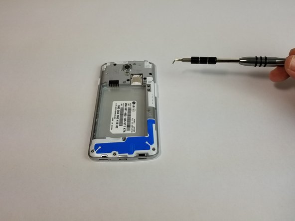

      • Pry back cover with finger in the crease.
      • Remove back casing.

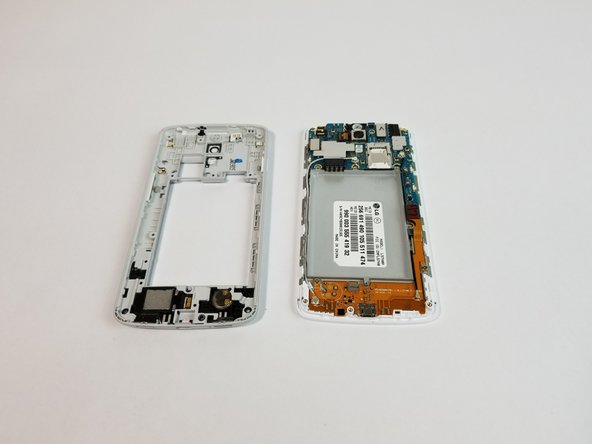

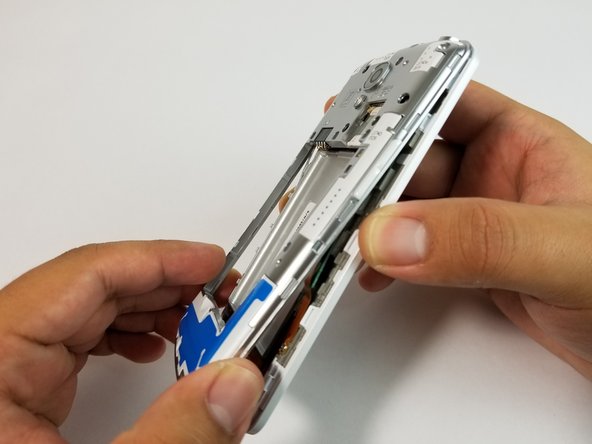

    4. LG Volt Charger Port Replacement: crwdns2935265:04crwdnd2935265:01crwdnd2935265:03crwdne2935265:0 LG Volt Charger Port Replacement: crwdns2935265:04crwdnd2935265:02crwdnd2935265:03crwdne2935265:0 LG Volt Charger Port Replacement: crwdns2935265:04crwdnd2935265:03crwdnd2935265:03crwdne2935265:0
      • Use the plastic opening tool to remove the back housing from the frame of the phone.

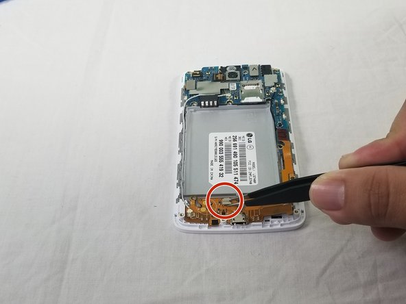

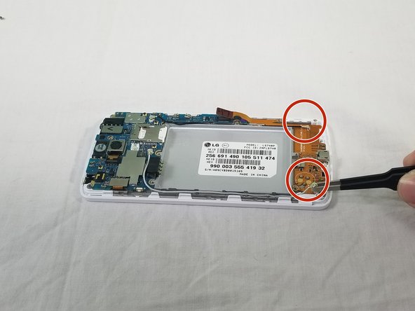

    5. LG Volt Charger Port Replacement: crwdns2935265:05crwdnd2935265:01crwdnd2935265:01crwdne2935265:0
      • Lift copper tab located on the right side of the device.

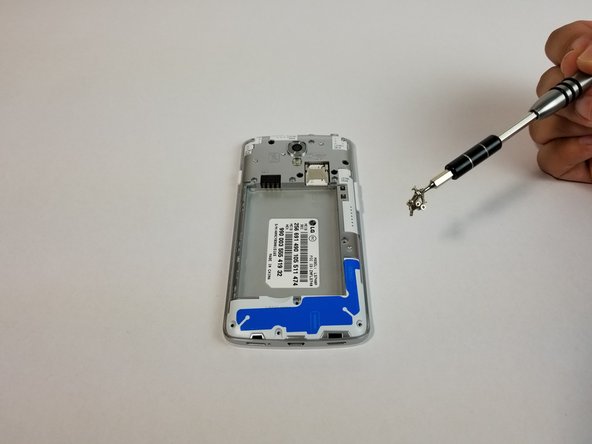

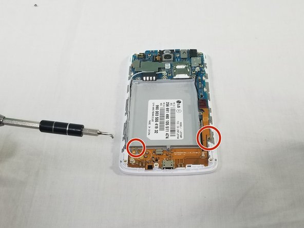

    6. LG Volt Charger Port Replacement: crwdns2935265:06crwdnd2935265:01crwdnd2935265:02crwdne2935265:0 LG Volt Charger Port Replacement: crwdns2935265:06crwdnd2935265:02crwdnd2935265:02crwdne2935265:0
      • Use a JIS #000 screwdriver to remove the 1 screw (4mm) on right side under copper tab.
      • Use a JIS #000 screwdriver to remove the screw (4mm) on bottom left under battery tray.

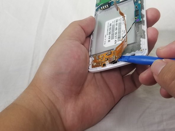

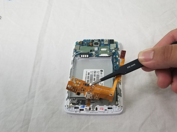

    8. LG Volt Charger Port Replacement: crwdns2935265:08crwdnd2935265:01crwdnd2935265:03crwdne2935265:0 LG Volt Charger Port Replacement: crwdns2935265:08crwdnd2935265:02crwdnd2935265:03crwdne2935265:0 LG Volt Charger Port Replacement: crwdns2935265:08crwdnd2935265:03crwdnd2935265:03crwdne2935265:0
      • Use the plastic opening tool to carefully lift the charger assembly from the phone.
      • Start from the copper tab and continue in a clockwise direction.
      • Once it is loose remove the assembly from the phone.
