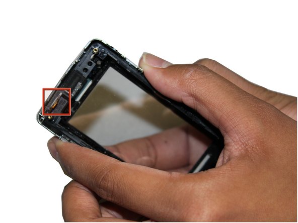

  12. LG Versa Touch Screen Replacement: crwdns2935265:012crwdnd2935265:01crwdnd2935265:01crwdne2935265:0
    • In the top right corner of the housing use a pry tool to disconnect the touch screen digitizer connector from the housing.
