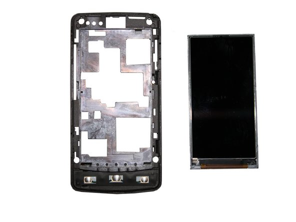

    • Simply lift the LCD screen from the logic board housing to remove the LCD screen.
  16. LG Versa LCD Screen Replacement: crwdns2935265:016crwdnd2935265:01crwdnd2935265:01crwdne2935265:0
    • Congratulations you have fully torn down the LG Versa.
  17. LG Versa LCD Screen Replacement, LCD Screen: crwdns2935265:017crwdnd2935265:01crwdnd2935265:01crwdne2935265:0
    • Remove the broken LCD Screen from the housing.
  18. LG Versa LCD Screen Replacement: crwdns2935265:018crwdnd2935265:01crwdnd2935265:02crwdne2935265:0 LG Versa LCD Screen Replacement: crwdns2935265:018crwdnd2935265:02crwdnd2935265:02crwdne2935265:0
    • Insert your new LCD Screen into the housing.
    • Place the ribbon cable through the hold as shown in the picture.
