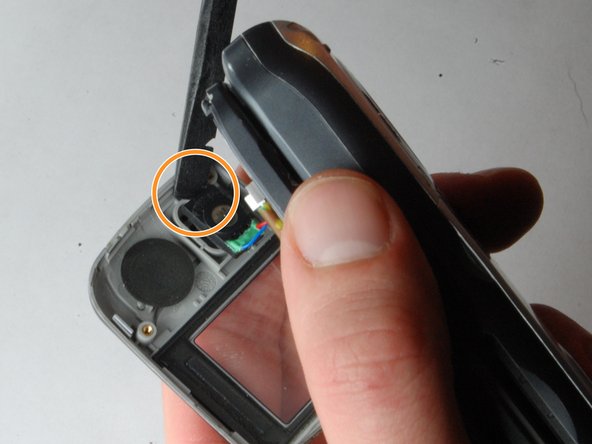

  6. LG VX9800 Logic Board Replacement: crwdns2935265:06crwdnd2935265:01crwdnd2935265:03crwdne2935265:0 LG VX9800 Logic Board Replacement: crwdns2935265:06crwdnd2935265:02crwdnd2935265:03crwdne2935265:0 LG VX9800 Logic Board Replacement: crwdns2935265:06crwdnd2935265:03crwdnd2935265:03crwdne2935265:0
    • The faceplate is still attached through speakers that travel from the ear-piece to the motherboard.
    • Carefully wedge the flat or pointed end of the spudger beneath the ear-piece and the faceplate.
    • This may require a bit of force, as the ear-piece is stuck to the faceplate with adhesive.
  7. LG VX9800 Logic Board Replacement: crwdns2935265:07crwdnd2935265:01crwdnd2935265:01crwdne2935265:0
    • The faceplate and keypad can now be completely removed from the phone.
