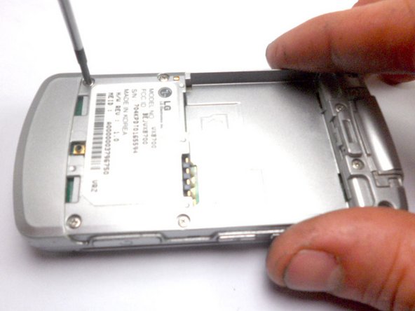

    1. LG VX8700 Motherboard Replacement, Keypad: crwdns2935265:03crwdnd2935265:01crwdnd2935265:02crwdne2935265:0 LG VX8700 Motherboard Replacement, Keypad: crwdns2935265:03crwdnd2935265:02crwdnd2935265:02crwdne2935265:0
      • Remove the nine 4 mm screws from the back cover with a Phillips #0 screwdriver.

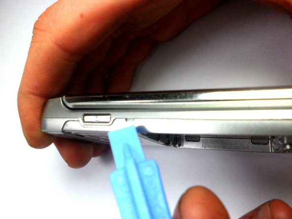

    2. LG VX8700 Motherboard Replacement: crwdns2935265:04crwdnd2935265:01crwdnd2935265:02crwdne2935265:0 LG VX8700 Motherboard Replacement: crwdns2935265:04crwdnd2935265:02crwdnd2935265:02crwdne2935265:0
      • Insert the tip of the iFixit opening tool into the small notch on the side of the case.
      • Slide the opening tool along the seam and around the edge of the phone to separate the case.

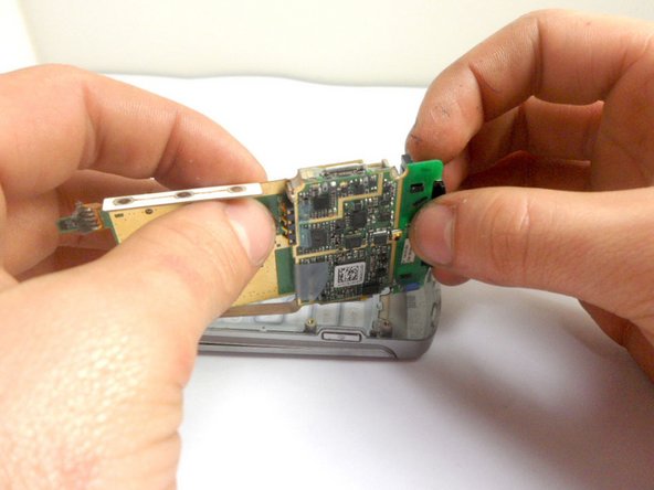

    4. LG VX8700 Motherboard Replacement: crwdns2935265:06crwdnd2935265:01crwdnd2935265:03crwdne2935265:0 LG VX8700 Motherboard Replacement: crwdns2935265:06crwdnd2935265:02crwdnd2935265:03crwdne2935265:0 LG VX8700 Motherboard Replacement: crwdns2935265:06crwdnd2935265:03crwdnd2935265:03crwdne2935265:0
      • Hold the phone casing with one hand and the keypad assembly with the other.
      • Separate the phone casing from the keypad/motherboard.

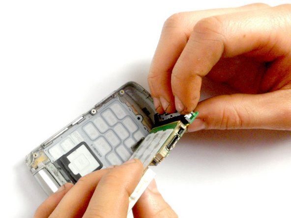

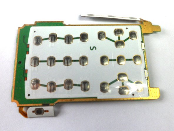

    5. LG VX8700 Motherboard Replacement: crwdns2935265:07crwdnd2935265:01crwdnd2935265:02crwdne2935265:0 LG VX8700 Motherboard Replacement: crwdns2935265:07crwdnd2935265:02crwdnd2935265:02crwdne2935265:0
      • Pull the two boards apart to separate the keypad from the motherboard.

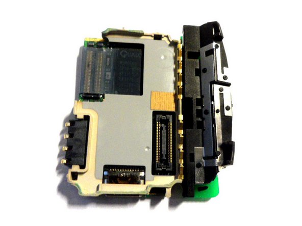

    1. LG VX8700 Motherboard Replacement, Motherboard: crwdns2935265:08crwdnd2935265:01crwdnd2935265:01crwdne2935265:0
      • First, pull back the tape covering the connection between the motherboard and the ribbon cable.
      • Separate the connection, using the plastic opening tool.
    2. LG VX8700 Motherboard Replacement: crwdns2935265:09crwdnd2935265:01crwdnd2935265:02crwdne2935265:0 LG VX8700 Motherboard Replacement: crwdns2935265:09crwdnd2935265:02crwdnd2935265:02crwdne2935265:0
      • After the connection is removed, the motherboard is successfully removed.
