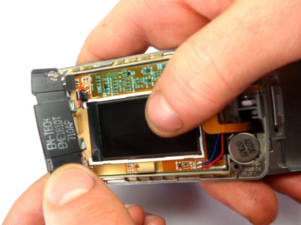

  7. LG VX8700 LCD Screen Replacement, Ear Piece: crwdns2935265:07crwdnd2935265:01crwdnd2935265:01crwdne2935265:0
    • Locate the earpiece, which is the black component at the top with black and red wires.
    • Remove the component. Using a soldering iron, desolder the top ear piece.
  8. LG VX8700 LCD Screen Replacement: crwdns2935265:08crwdnd2935265:01crwdnd2935265:02crwdne2935265:0 LG VX8700 LCD Screen Replacement: crwdns2935265:08crwdnd2935265:02crwdnd2935265:02crwdne2935265:0
    • Using the plastic opening tool, lift the earpiece to remove it from the phone.
  9. LG VX8700 LCD Screen Replacement, LCD Screen: crwdns2935265:09crwdnd2935265:01crwdnd2935265:01crwdne2935265:0
    • Using a soldering iron, desolder the wires connected to the LCD board.
  10. LG VX8700 LCD Screen Replacement: crwdns2935265:010crwdnd2935265:01crwdnd2935265:01crwdne2935265:0
    • Using the plastic opening tool, carefully disconnect the ribbon connecting the two pieces.
  11. LG VX8700 LCD Screen Replacement: crwdns2935265:011crwdnd2935265:01crwdnd2935265:01crwdne2935265:0
    • Remove the LCD screen.
