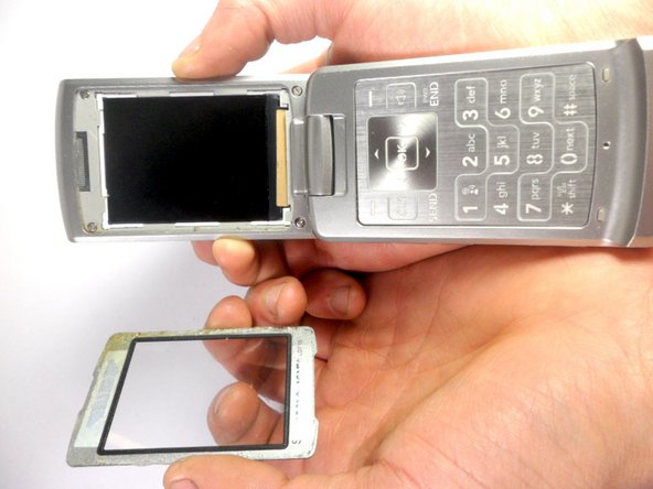

  3. LG VX8700 Front Bezel Replacement, Front Bezel: crwdns2935265:03crwdnd2935265:01crwdnd2935265:01crwdne2935265:0
    • Turn your phone around and open the flip phone. The screen is now facing you.
    • Locate the two grey rubber plugs on the bottom corners of the screen. These plugs cover up two screws.
    • Remove the two grey screw-covers.
  4. LG VX8700 Front Bezel Replacement: crwdns2935265:04crwdnd2935265:01crwdnd2935265:02crwdne2935265:0 LG VX8700 Front Bezel Replacement: crwdns2935265:04crwdnd2935265:02crwdnd2935265:02crwdne2935265:0
    • Use the ejection tab at the top to remove the screen.
    • There is a gap between the case and the screen near the ear piece.
    • Insert the plastic opening tool in the gap and pry up the screen.
    • The plastic screen cover is glued onto the phone. It may be difficult to pry off.

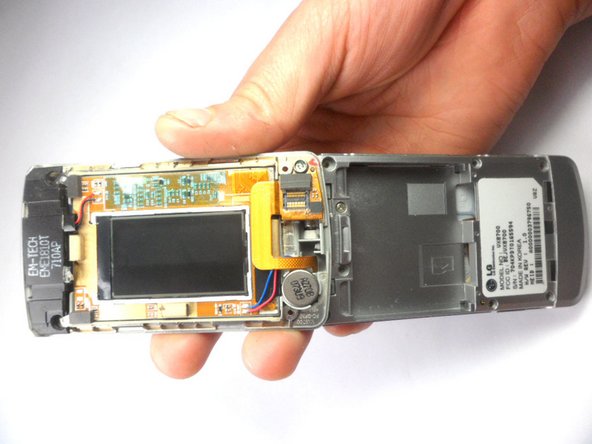

  5. LG VX8700 Front Bezel Replacement: crwdns2935265:05crwdnd2935265:01crwdnd2935265:01crwdne2935265:0
    • Unscrew the four corners of the screen using 3.21mm screws to separate the top cover of the phone.
  6. LG VX8700 Front Bezel Replacement: crwdns2935265:06crwdnd2935265:01crwdnd2935265:02crwdne2935265:0 LG VX8700 Front Bezel Replacement: crwdns2935265:06crwdnd2935265:02crwdnd2935265:02crwdne2935265:0
    • Turn your phone around. The battery side will be facing you.
    • Insert the plastic opening tool into the groove to remove the top cover of the phone.
    • Carefully open the cover.
