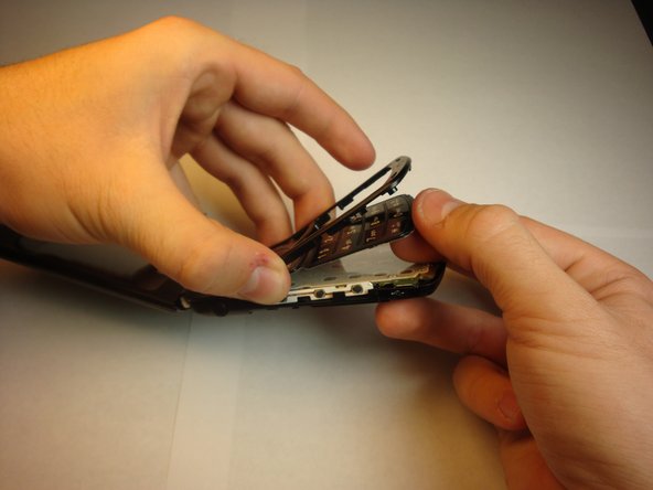

    2. LG VX8560 Keypad Replacement: crwdns2935265:02crwdnd2935265:01crwdnd2935265:02crwdne2935265:0 LG VX8560 Keypad Replacement: crwdns2935265:02crwdnd2935265:02crwdnd2935265:02crwdne2935265:0
      • Insert the iFixit Opening Tool between the phone’s keypad cover and the back cover, and gently pull apart.
      • Be careful with the motherboard; don’t let it detach.
