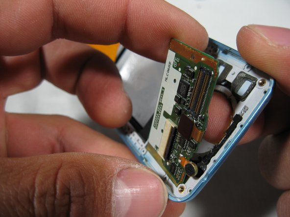

  24. LG VX8550 Scroll Wheel Replacement, Scroll Wheel: crwdns2935265:024crwdnd2935265:01crwdnd2935265:02crwdne2935265:0 LG VX8550 Scroll Wheel Replacement, Scroll Wheel: crwdns2935265:024crwdnd2935265:02crwdnd2935265:02crwdne2935265:0
    • Carefully lift the circuit board away from the screen casing using Ipod Opening Tool.
    • Peel the circuit board away from the adhesive backing with your finger.
  25. LG VX8550 Scroll Wheel Replacement: crwdns2935265:025crwdnd2935265:01crwdnd2935265:01crwdne2935265:0
    • Remove the scroll wheel from the casing with your hands.
