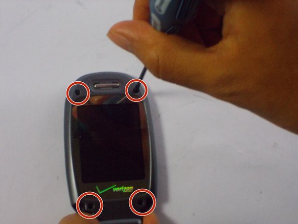

  4. LG VX8300 Screen Housing Replacement: crwdns2935265:04crwdnd2935265:01crwdnd2935265:02crwdne2935265:0 LG VX8300 Screen Housing Replacement: crwdns2935265:04crwdnd2935265:02crwdnd2935265:02crwdne2935265:0
    • Use a Phillips #00 screwdriver to remove all four 3mm screws from the back of the phone.

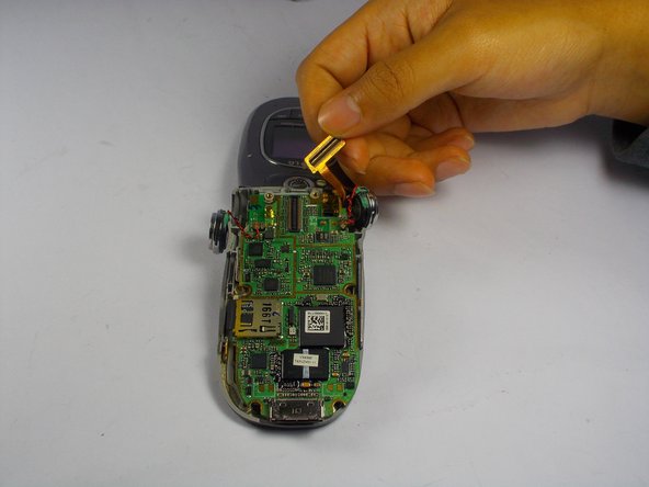

  7. LG VX8300 Screen Housing Replacement: crwdns2935265:07crwdnd2935265:01crwdnd2935265:02crwdne2935265:0 LG VX8300 Screen Housing Replacement: crwdns2935265:07crwdnd2935265:02crwdnd2935265:02crwdne2935265:0
    • Remove the ribbon cable by lifting up the orange rectangle in the middle-top portion of the exposed device.

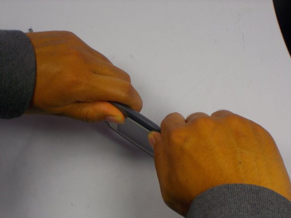

  8. LG VX8300 Screen Housing Replacement: crwdns2935265:08crwdnd2935265:01crwdnd2935265:02crwdne2935265:0 LG VX8300 Screen Housing Replacement: crwdns2935265:08crwdnd2935265:02crwdnd2935265:02crwdne2935265:0
    • Hold the phone securely in your left hand by placing your thumb on the hinge and wrapping your fingers around the back of the device.
    • Pinch the right flange near the flip hinge with the right hand and apply pressure.
    • Continue applying pressure until the two halves separate. Pull the bottom half towards you.

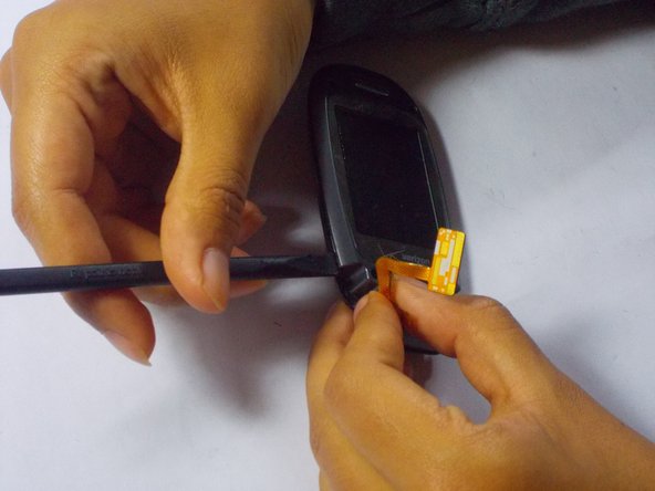

  9. LG VX8300 Screen Housing Replacement: crwdns2935265:09crwdnd2935265:01crwdnd2935265:02crwdne2935265:0 LG VX8300 Screen Housing Replacement: crwdns2935265:09crwdnd2935265:02crwdnd2935265:02crwdne2935265:0
    • Separate the keyboard from its housing.
    • Slide the ribbon cable out through the uppermost slot in the housing.

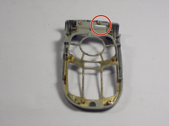

  10. LG VX8300 Screen Housing Replacement: crwdns2935265:010crwdnd2935265:01crwdnd2935265:02crwdne2935265:0 LG VX8300 Screen Housing Replacement: crwdns2935265:010crwdnd2935265:02crwdnd2935265:02crwdne2935265:0
    • Remove the four rubber screw covers with tweezers located on the corners of the internal screen.
    • Remove all four 2 by 3 mm Phillips screws located under the rubber pads using a Phillips #00 screwdriver.

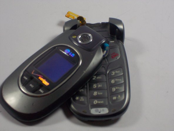

  11. LG VX8300 Screen Housing Replacement: crwdns2935265:011crwdnd2935265:01crwdnd2935265:02crwdne2935265:0 LG VX8300 Screen Housing Replacement: crwdns2935265:011crwdnd2935265:02crwdnd2935265:02crwdne2935265:0
    • Guide the spudger along the seam line of the phone screen to slowly separate the two pieces.
  12. LG VX8300 Screen Housing Replacement: crwdns2935265:012crwdnd2935265:01crwdnd2935265:02crwdne2935265:0 LG VX8300 Screen Housing Replacement: crwdns2935265:012crwdnd2935265:02crwdnd2935265:02crwdne2935265:0
    • Separate the external screen housing with your hands.
    • Replace the old screen housing with a new one and snap it together to complete the replacement.
