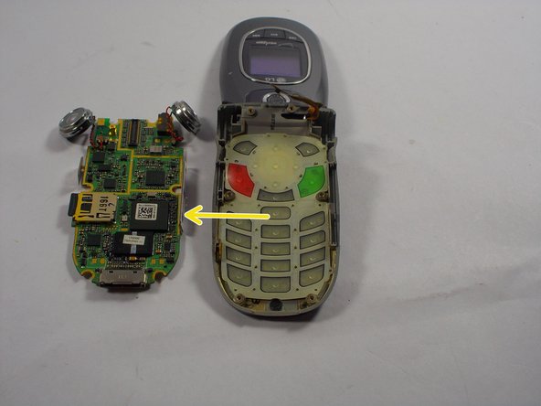

    • Holding the chassis firmly in one hand, then lift up on the charging port with the edge of an opening tool to separate the logic board from the front body case.
    • Use the spudger tool to gently lift the board out of the case. The board is secured by six holes around its perimeter and will become free when pried from the supports.

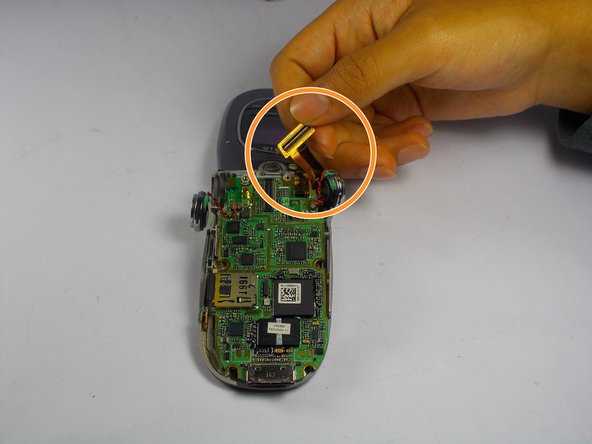

    • Without putting tension on the wiring, remove the speakers one at a time.
    • Remove the ribbon cable by lifting it up with your finger. Set it aside.
    • Remove the logic board completely from the case and set it aside. You can now remove the button pad with your fingers or the spudger tool.

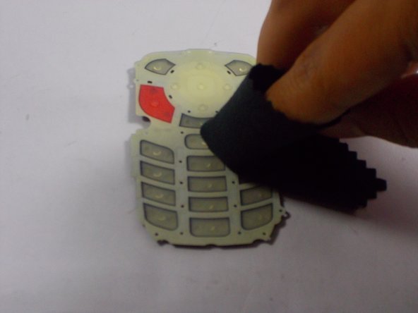

    • Cleaning: You may use a brush to remove debris between individual buttons. Use a soft cloth to clean the underside of the pad.
    • Replacing: Remove the old pad and insert the new pad into the case.
