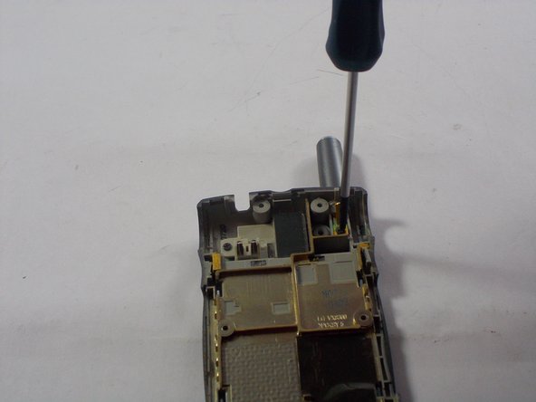

  6. LG VX8300 Antenna Replacement, Antenna Replacement: crwdns2935265:06crwdnd2935265:01crwdnd2935265:03crwdne2935265:0 LG VX8300 Antenna Replacement, Antenna Replacement: crwdns2935265:06crwdnd2935265:02crwdnd2935265:03crwdne2935265:0 LG VX8300 Antenna Replacement, Antenna Replacement: crwdns2935265:06crwdnd2935265:03crwdnd2935265:03crwdne2935265:0
    • Place the phone in front of you. With the antenna in the top right corner, and the opened back panel facing up.
    • Use a Phillips #00 Screwdriver to remove the single 2mm x 3mm screw. Found on the gold band, just underneath the antenna.

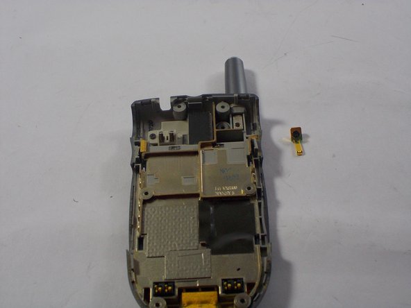

  7. LG VX8300 Antenna Replacement: crwdns2935265:07crwdnd2935265:01crwdnd2935265:01crwdne2935265:0
    • Remove the antenna by pulling it straight and out of its housing.
    • The phone is now ready for a new antenna.
  8. LG VX8300 Antenna Replacement: crwdns2935265:08crwdnd2935265:01crwdnd2935265:01crwdne2935265:0
    • Insert the new antenna by pushing it straight into its housing on the phone.
  9. LG VX8300 Antenna Replacement: crwdns2935265:09crwdnd2935265:01crwdnd2935265:01crwdne2935265:0
    • Place the 2mm x 3mm screw back onto the gold band, just underneath the antenna. Use a Phillips #00 Screwdriver to replace the screw that you removed in step one.
You have now successfully completed the antenna replacement for an LG VX8300 flip phone.
