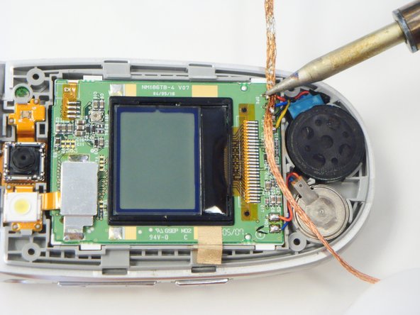

    • Locate the four solder joints (connected to the yellow, black, blue, and red wires) on the bottom part of the phone, connected to the speaker. It will appear as a black circular part with some holes in it.
    • Place a piece of solder wick on top of the solders.
    • Very carefully, place the tip of the soldering iron on top of the solder wick. Hold it steady until the solder is soaked up into the solder wick.
    • Soldering iron will damage circuitry if held down for too long.
    • Cut off the used solder wick with pliers and repeat this step if any solder remains.
