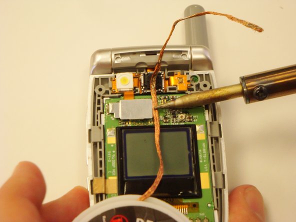

    1. LG VX6100 Main Display Replacement, Main Display: crwdns2935265:09crwdnd2935265:01crwdnd2935265:02crwdne2935265:0 LG VX6100 Main Display Replacement, Main Display: crwdns2935265:09crwdnd2935265:02crwdnd2935265:02crwdne2935265:0
      • Locate the solder on the side of the metal plate on the top half of the phone.
      • Place a piece of solder wick on top of the solder.
      • To desolder the connection, very carefully place the tip of the soldering iron on top of the solder wick. Hold it steady until the solder is soaked up into the solder wick.
      • The soldering iron will damage circuitry if held down for too long.
      • Cut off the used solder wick with pliers and repeat this step if any solder remains.
    2. LG VX6100 Main Display Replacement: crwdns2935265:010crwdnd2935265:01crwdnd2935265:01crwdne2935265:0
      • After the solder has been removed, pry off the camera assembly connection shield with the plastic opening tool.

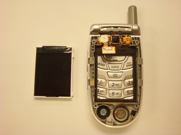

    3. LG VX6100 Main Display Replacement: crwdns2935265:011crwdnd2935265:01crwdnd2935265:02crwdne2935265:0 LG VX6100 Main Display Replacement: crwdns2935265:011crwdnd2935265:02crwdnd2935265:02crwdne2935265:0
      • Remove the main display by lifting up the extruded white edge with your fingernail.
