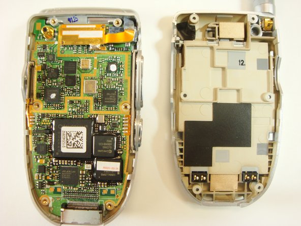

    5. LG VX6100 Logic Board Replacement: crwdns2935265:05crwdnd2935265:01crwdnd2935265:02crwdne2935265:0 LG VX6100 Logic Board Replacement: crwdns2935265:05crwdnd2935265:02crwdnd2935265:02crwdne2935265:0
      • Insert a plastic opener tool through the seam between the back case and the rest of the phone.
      • Slowly slide the tool along the seam. Lift up on the back case while you do this until the back case comes apart.

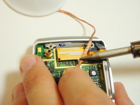

    1. LG VX6100 Logic Board Replacement, Logic Board: crwdns2935265:06crwdnd2935265:01crwdnd2935265:02crwdne2935265:0 LG VX6100 Logic Board Replacement, Logic Board: crwdns2935265:06crwdnd2935265:02crwdnd2935265:02crwdne2935265:0
      • Locate the solder joint on the top portion of the logic board. It will appear as a shiny silver bead of metal.
      • Place a piece of solder wick on top of the solder.
      • To desolder the connection, very carefully place the tip of the soldering iron on top of the solder wick. Hold it steady until the solder is soaked up into the solder wick.
      • The soldering iron will damage circuitry if held down for too long.
      • Cut off the used solder wick with pliers and repeat above steps if any solder remains.

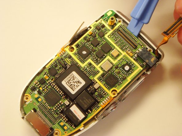

    2. LG VX6100 Logic Board Replacement: crwdns2935265:07crwdnd2935265:01crwdnd2935265:02crwdne2935265:0 LG VX6100 Logic Board Replacement: crwdns2935265:07crwdnd2935265:02crwdnd2935265:02crwdne2935265:0
      • One the solder is gone, pry the copper piece off the logic board.
      • You can then remove the logic board from the case.
