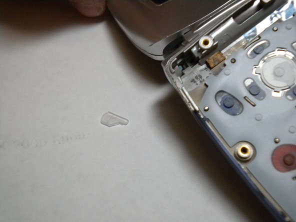

  9. LG VX6000 Screen Replacement, Screen: crwdns2935265:09crwdnd2935265:01crwdnd2935265:03crwdne2935265:0 LG VX6000 Screen Replacement, Screen: crwdns2935265:09crwdnd2935265:02crwdnd2935265:03crwdne2935265:0 LG VX6000 Screen Replacement, Screen: crwdns2935265:09crwdnd2935265:03crwdnd2935265:03crwdne2935265:0

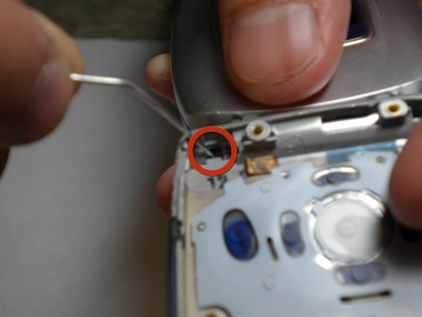

    • Using a paper clip or tweezers, pop out the screen by pressing the plastic tab in the top-left corner of the phone's bottom casing as indicated in the photo.
    • Be careful not to lose the tab that pops out. It is a small and clear piece of plastic.
    • The tab is fragile, handle with care.

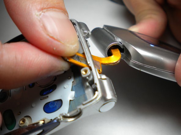

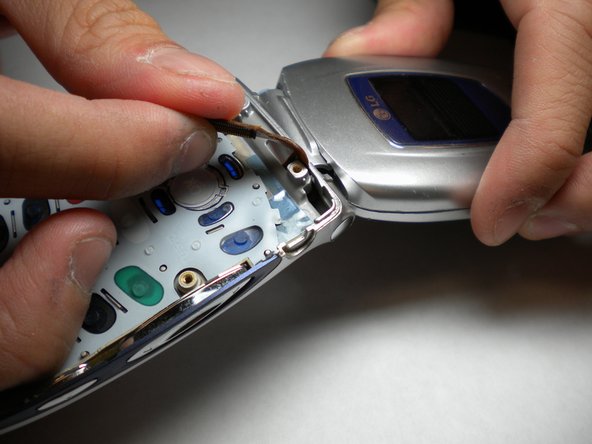

    • As shown in the photos, pull the orange strip through a thin opening at the top of the phone. Once this is done, the top and bottom halves can be separated.

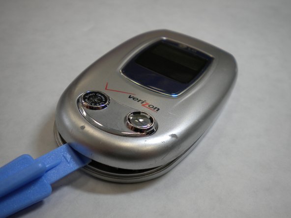

    • Carefully open the casing using the iFixit plastic tool by prying each side a little bit at a time. Rotate and open until all the inside clips pop open and the casing opens up.

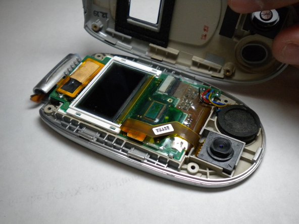

  14. LG VX6000 Screen Replacement: crwdns2935265:014crwdnd2935265:01crwdnd2935265:02crwdne2935265:0 LG VX6000 Screen Replacement: crwdns2935265:014crwdnd2935265:02crwdnd2935265:02crwdne2935265:0
    • After you pry open the casing, you will be left with the screen and circuit board in the top face plate.
    • Gently pull the corner of screen and circuit board up and out of casing to remove screen from the top face plate.
    • Do not try to completely separate the circuit board from the casing. There are still wires connecting the two.

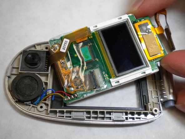

  15. LG VX6000 Screen Replacement: crwdns2935265:015crwdnd2935265:01crwdnd2935265:01crwdne2935265:0
    • Rotate the screen and the connected white frame away from the logic board.
    • Carefully peel the adhesive tape that connects the screen and logic board off. The screen can now be removed and replaced with a new screen unit.
