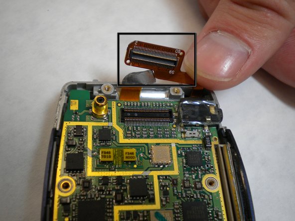

  7. LG VX6000 Keyboard Replacement: crwdns2935265:07crwdnd2935265:01crwdnd2935265:02crwdne2935265:0 LG VX6000 Keyboard Replacement: crwdns2935265:07crwdnd2935265:02crwdnd2935265:02crwdne2935265:0
    • Locate the yellow connection towards the top of the phone. This is directly connected to the screen.
    • Carefully pry the connector away from the motherboard to remove it from the phone.
    • Do not pull forcefully
