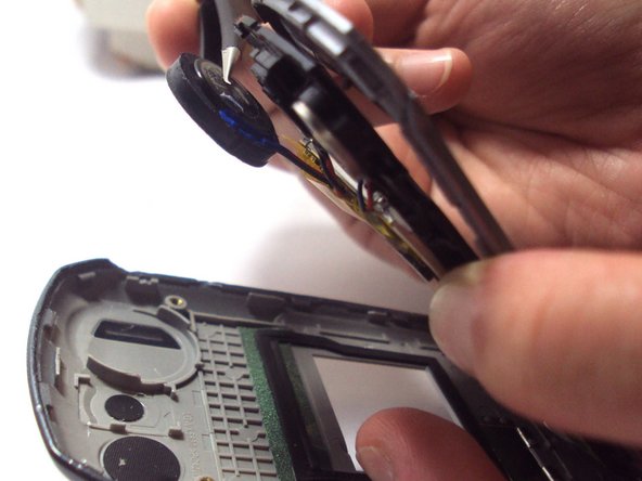

    3. LG VX5600 Camera Replacement: crwdns2935265:09crwdnd2935265:01crwdnd2935265:02crwdne2935265:0 LG VX5600 Camera Replacement: crwdns2935265:09crwdnd2935265:02crwdnd2935265:02crwdne2935265:0
      • The vibrating motor remains attached to the external cover, so use the tweezers to grasp the vibrating motor and lift it up towards the black plastic cover around the screens.
      • The vibrating motor is adhered with glue, so it may take some force to pry it off the outer grey cover of the phone.
    4. LG VX5600 Camera Replacement: crwdns2935265:010crwdnd2935265:01crwdnd2935265:01crwdne2935265:0
      • Flip the phone over so that the front of the top portion is facing you.
      • Use your hands to lift the cover up and off, removing it from the phone.

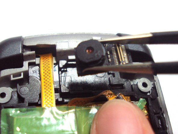

    5. LG VX5600 Camera Replacement: crwdns2935265:011crwdnd2935265:01crwdnd2935265:01crwdne2935265:0
      • Use your fingers to grasp the gold flex cable where it is attached to the camera.
      • Use the tweezers to grasp the bottom of the connection between the flex cable and camera.
      • Slowly pull upwards with your hands until the flex cable detaches from the camera.
    6. LG VX5600 Camera Replacement: crwdns2935265:012crwdnd2935265:01crwdnd2935265:02crwdne2935265:0 LG VX5600 Camera Replacement: crwdns2935265:012crwdnd2935265:02crwdnd2935265:02crwdne2935265:0
      • Use the tweezers to lift up the detached flex cable from the camera and then use your finger to hold it back.
      • Use the tweezers to lift the camera up and out of the phone.
