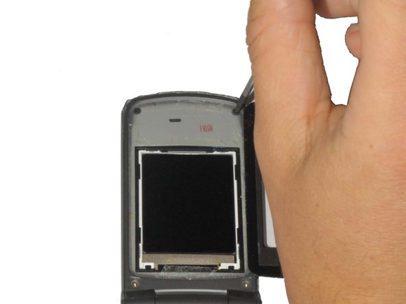

    1. LG VX5500 Screen Replacement, Screen: crwdns2935265:02crwdnd2935265:01crwdnd2935265:02crwdne2935265:0 LG VX5500 Screen Replacement, Screen: crwdns2935265:02crwdnd2935265:02crwdnd2935265:02crwdne2935265:0
      • Carefully pry off the black plastic screen cover using the iSesamo tool or another thin, flat tool.
      • The screen cover is adhered to the phone and may take some effort to pry off. If it is too difficult to remove, heat the screen with a hair dryer on low for 30 seconds to soften the adhesive.

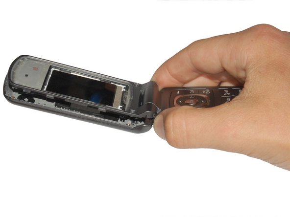

    3. LG VX5500 Screen Replacement: crwdns2935265:04crwdnd2935265:01crwdnd2935265:03crwdne2935265:0 LG VX5500 Screen Replacement: crwdns2935265:04crwdnd2935265:02crwdnd2935265:03crwdne2935265:0 LG VX5500 Screen Replacement: crwdns2935265:04crwdnd2935265:03crwdnd2935265:03crwdne2935265:0
      • Pry off the front panel of the phone using a Plastic Opening Tool.
      • Push the tool into the crack along the side of the phone.
      • Slide the tool along the crack to detach the tabs holding the backing on the phone.

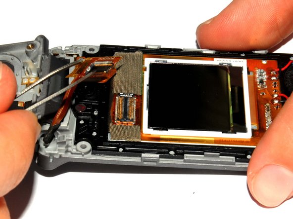

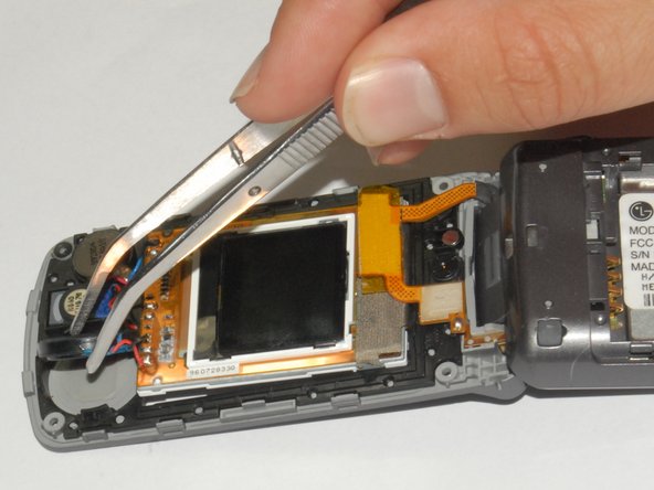

    4. LG VX5500 Screen Replacement: crwdns2935265:05crwdnd2935265:01crwdnd2935265:02crwdne2935265:0 LG VX5500 Screen Replacement: crwdns2935265:05crwdnd2935265:02crwdnd2935265:02crwdne2935265:0
      • Use the tweezers to lift the display adapter off the screen component.

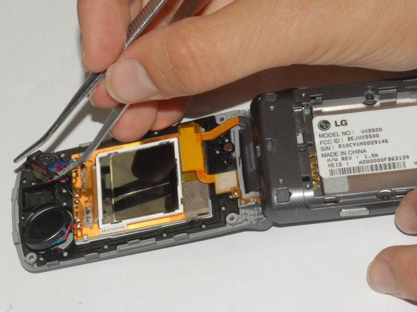

    5. LG VX5500 Screen Replacement: crwdns2935265:06crwdnd2935265:01crwdnd2935265:02crwdne2935265:0 LG VX5500 Screen Replacement: crwdns2935265:06crwdnd2935265:02crwdnd2935265:02crwdne2935265:0
      • Using tweezers remove the speaker from its casing.
      • The speaker is adhered to the phone casing so it will take a small amount of force to remove it.
    6. LG VX5500 Screen Replacement: crwdns2935265:07crwdnd2935265:01crwdnd2935265:02crwdne2935265:0 LG VX5500 Screen Replacement: crwdns2935265:07crwdnd2935265:02crwdnd2935265:02crwdne2935265:0
      • Remove the earpiece by lifting it out of the phone casing using tweezers.
      • The earpiece is adhered to the phone casing so it will take a small amount of force to remove it.

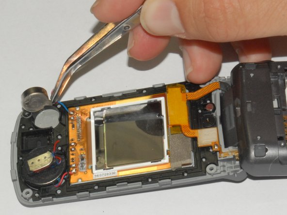

    7. LG VX5500 Screen Replacement: crwdns2935265:08crwdnd2935265:01crwdnd2935265:02crwdne2935265:0 LG VX5500 Screen Replacement: crwdns2935265:08crwdnd2935265:02crwdnd2935265:02crwdne2935265:0
      • Remove the vibration motor by lifting it out of the phone casing using tweezers.
      • The motor is adhered to the phone casing so it will take a small amount of force to remove it.

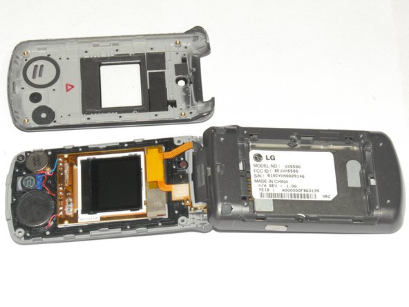

    8. LG VX5500 Screen Replacement: crwdns2935265:09crwdnd2935265:01crwdnd2935265:01crwdne2935265:0
      • Lift the screen components out of the phone.
