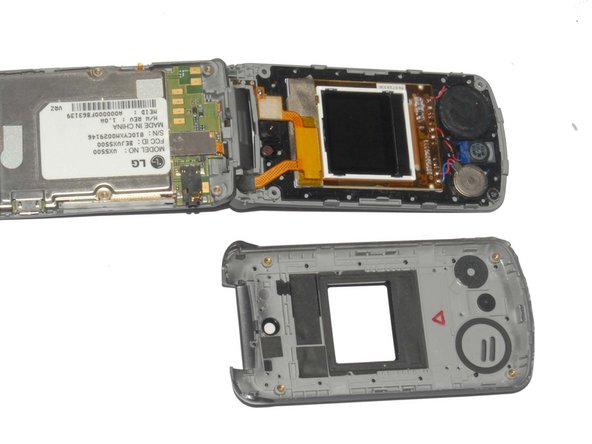

      • Carefully pry off the phone's backing using a plastic opening tool.
      • Slip the tool into the crack between the keypad (front panel) and the back panel.
      • Slide the tool along the sides of the phone to detach the tabs holding the backing on.

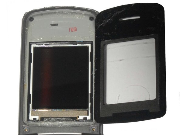

    1. LG VX5500 Phone Casing Replacement, Phone Casing: crwdns2935265:06crwdnd2935265:01crwdnd2935265:02crwdne2935265:0 LG VX5500 Phone Casing Replacement, Phone Casing: crwdns2935265:06crwdnd2935265:02crwdnd2935265:02crwdne2935265:0

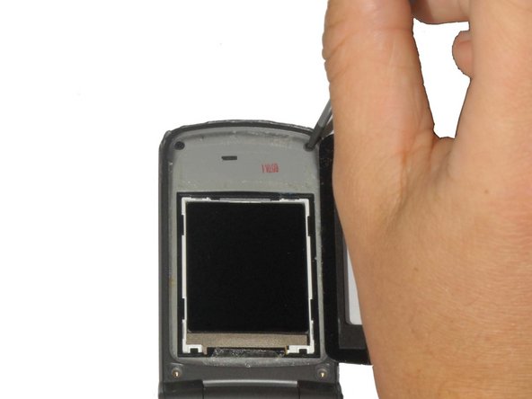

      • Carefully pry off the black plastic screen cover using the iSesamo tool or another thin, flat tool.
      • The screen cover is adhered to the phone and may take some effort to pry off. If it is too difficult to remove, heat the screen with a hair dryer on low for 30 seconds to soften the adhesive.

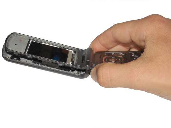

      • Pry off the front panel of the phone using a Plastic Opening Tool.
      • Push the tool into the crack along the side of the phone.
      • Slide the tool along the crack to detach the tabs holding the backing on the phone.

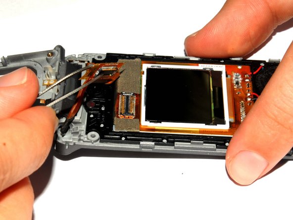

      • Use the tweezers to lift the display adapter off the screen component.

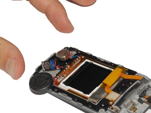

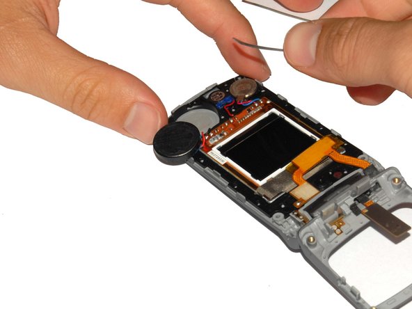

      • Using tweezers remove the speaker from its casing.
      • The speaker is adhered to the phone casing so it will take a small amount of force to remove it.
    6. LG VX5500 Phone Casing Replacement: crwdns2935265:011crwdnd2935265:01crwdnd2935265:02crwdne2935265:0 LG VX5500 Phone Casing Replacement: crwdns2935265:011crwdnd2935265:02crwdnd2935265:02crwdne2935265:0
      • Remove the earpiece and gyroscope by lifting them out of the phone casing using tweezers.
      • The earpiece and gyroscope are adhered to the phone casing so it will take a small amount of force to remove them.
      • Be careful when removing these components as the connecting wires are easily broken/disconnected.
