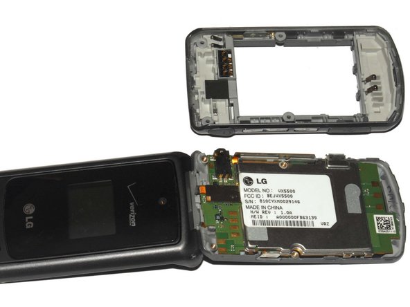

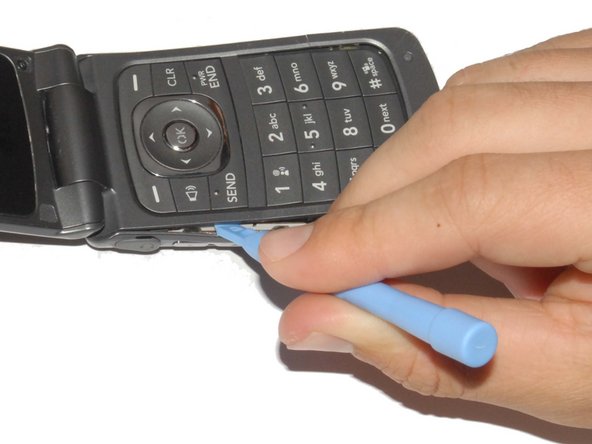

    2. LG VX5500 Mother Board Replacement: crwdns2935265:03crwdnd2935265:01crwdnd2935265:03crwdne2935265:0 LG VX5500 Mother Board Replacement: crwdns2935265:03crwdnd2935265:02crwdnd2935265:03crwdne2935265:0 LG VX5500 Mother Board Replacement: crwdns2935265:03crwdnd2935265:03crwdnd2935265:03crwdne2935265:0
      • Carefully pry off the phone's backing using a plastic opening tool.
      • Slip the tool into the crack between the keypad (front panel) and the back panel.
      • Slide the tool along the sides of the phone to detach the tabs holding the backing on.

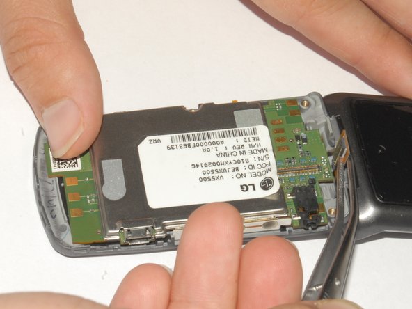

    3. LG VX5500 Mother Board Replacement: crwdns2935265:04crwdnd2935265:01crwdnd2935265:02crwdne2935265:0 LG VX5500 Mother Board Replacement: crwdns2935265:04crwdnd2935265:02crwdnd2935265:02crwdne2935265:0
      • Peel back the sticker with tweezers and hold it back with your finger.
      • Use the tweezers to lift the display adapter off the logic board.

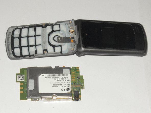

    4. LG VX5500 Mother Board Replacement: crwdns2935265:05crwdnd2935265:01crwdnd2935265:02crwdne2935265:0 LG VX5500 Mother Board Replacement: crwdns2935265:05crwdnd2935265:02crwdnd2935265:02crwdne2935265:0
      • Lift the mother board out of the phone casing.
      • The keyboard can be easily removed once the mother board is out of the phone.
