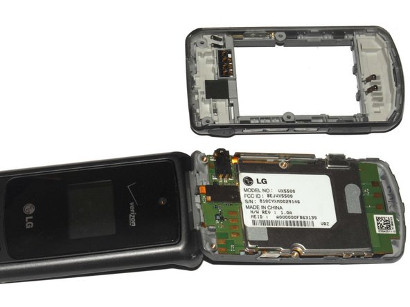

      • Remove the battery cover by placing your thumb on the small ridge near the top of the phone back and push downward, exposing the battery.
      • Our device did not come with a battery cover so it is not shown here.
      • Remove the battery using your finger to pry it out of the battery housing.
    1. LG VX5500 Audio Port Replacement, Audio Port: crwdns2935265:02crwdnd2935265:01crwdnd2935265:02crwdne2935265:0 LG VX5500 Audio Port Replacement, Audio Port: crwdns2935265:02crwdnd2935265:02crwdnd2935265:02crwdne2935265:0
      • Remove the (2) rubber screw covers located near the hinge of the phone using tweezers or a thumb tack.
      • Unscrew the (4) 3.6mm screws using a #00 Phillip's head screw driver.

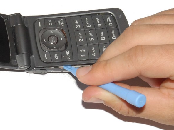

    2. LG VX5500 Audio Port Replacement: crwdns2935265:03crwdnd2935265:01crwdnd2935265:03crwdne2935265:0 LG VX5500 Audio Port Replacement: crwdns2935265:03crwdnd2935265:02crwdnd2935265:03crwdne2935265:0 LG VX5500 Audio Port Replacement: crwdns2935265:03crwdnd2935265:03crwdnd2935265:03crwdne2935265:0
      • Carefully pry off the phone's backing using a plastic opening tool.
      • Slip the tool into the crack between the keypad (front panel) and the back panel.
      • Slide the tool along the sides of the phone to detach the tabs holding the backing on.

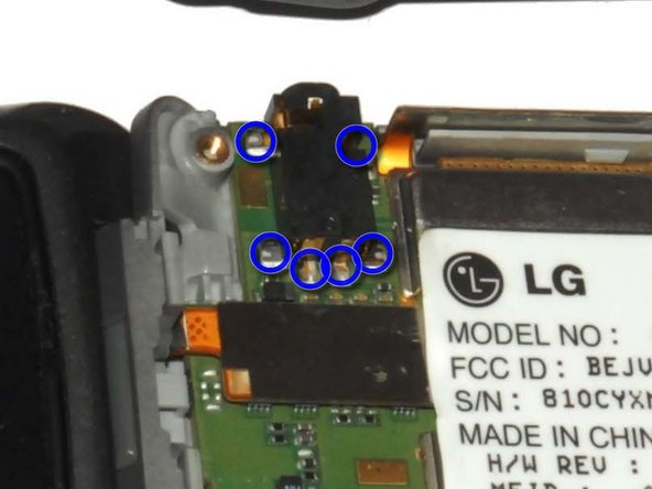

    3. LG VX5500 Audio Port Replacement: crwdns2935265:04crwdnd2935265:01crwdnd2935265:02crwdne2935265:0 LG VX5500 Audio Port Replacement: crwdns2935265:04crwdnd2935265:02crwdnd2935265:02crwdne2935265:0
      • Locate the audio port; this is what it should look like.
      • The audio port is mounted and connected at 6 points. Check the integrity of these connections.
      • If any of the connections are dislodged or the audio port is damaged, desolder the port and install a new one.
