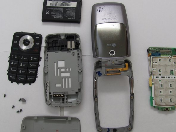

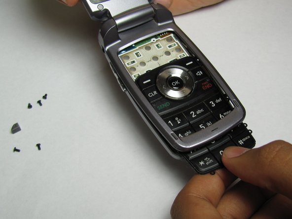

    1. LG VX5400 Phone Casing Replacement, Outer Casing: crwdns2935265:04crwdnd2935265:01crwdnd2935265:01crwdne2935265:0
      • Take the Philips screwdriver and unscrew the four visible screws on the backside of the phone indicated by the four red circles.
    2. LG VX5400 Phone Casing Replacement: crwdns2935265:05crwdnd2935265:01crwdnd2935265:01crwdne2935265:0
      • Then, take the pointed end of a spudger and pry out the rubber stopper to reveal the last screw at the top indicated with the blue circle.

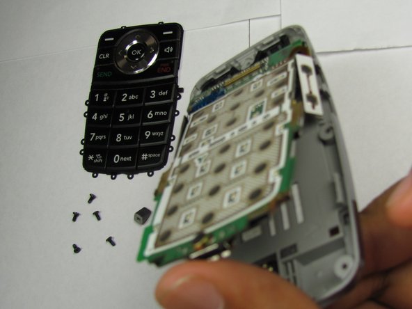

    1. LG VX5400 Phone Casing Replacement, Phone Casing: crwdns2935265:06crwdnd2935265:01crwdnd2935265:03crwdne2935265:0 LG VX5400 Phone Casing Replacement, Phone Casing: crwdns2935265:06crwdnd2935265:02crwdnd2935265:03crwdne2935265:0 LG VX5400 Phone Casing Replacement, Phone Casing: crwdns2935265:06crwdnd2935265:03crwdnd2935265:03crwdne2935265:0
      • Pry open the phone and remove the keypad and logic board.
    2. LG VX5400 Phone Casing Replacement: crwdns2935265:07crwdnd2935265:01crwdnd2935265:02crwdne2935265:0 LG VX5400 Phone Casing Replacement: crwdns2935265:07crwdnd2935265:02crwdnd2935265:02crwdne2935265:0
      • Lay out and organize the parts of the phone. You can now put the inner parts of the phone into the new case.
