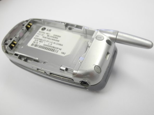

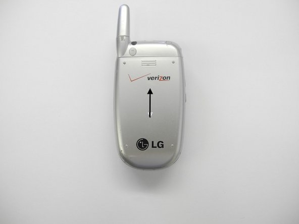

    • Carefully slide battery cover off in a downward direction.
    • Using the plastic opening tool, remove the battery. Light force may be necessary.
  2. LG VX5300 Keypad Replacement: crwdns2935265:02crwdnd2935265:01crwdnd2935265:01crwdne2935265:0
    • Using a Phillips #0 screwdriver, remove the five screws from the back cover and carefully set them aside.
  3. LG VX5300 Keypad Replacement: crwdns2935265:03crwdnd2935265:01crwdnd2935265:01crwdne2935265:0
    • Using the plastic opening tool, carefully lift the back cover off.

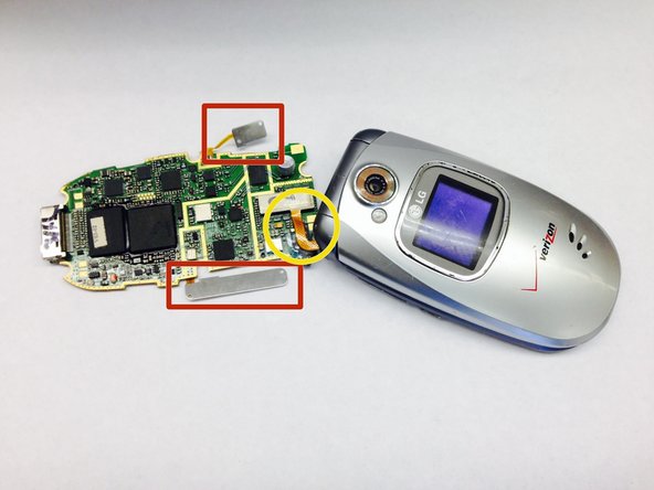

  4. LG VX5300 Keypad Replacement, Keypad: crwdns2935265:04crwdnd2935265:01crwdnd2935265:02crwdne2935265:0 LG VX5300 Keypad Replacement, Keypad: crwdns2935265:04crwdnd2935265:02crwdnd2935265:02crwdne2935265:0
    • Before touching anything inside the phone: it is crucial that you are very cautious when working around the wiring and sensor bars.
    • Look to the following photo for the location of the two sensor bars.
    • Without disconnecting the orange wire, carefully flip the computer chip over and lay flat on the table, exposing the keypad.

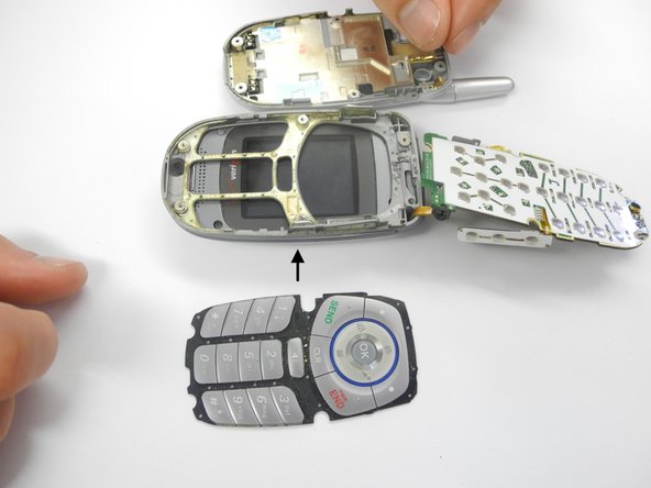

  5. LG VX5300 Keypad Replacement: crwdns2935265:05crwdnd2935265:01crwdnd2935265:02crwdne2935265:0 LG VX5300 Keypad Replacement: crwdns2935265:05crwdnd2935265:02crwdnd2935265:02crwdne2935265:0
    • Carefully remove the keypad and replace with the new keypad.
    • If sensor bars behind the volume and camera buttons fall out, gently put them back in place behind the buttons.
