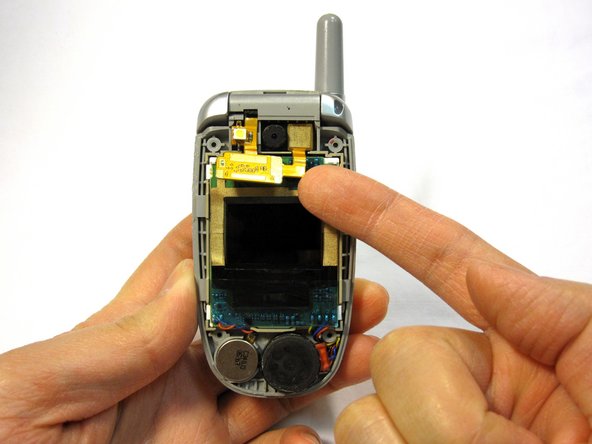

  7. LG VX5200 LCD Screen Replacement, LCD Screen: crwdns2935265:07crwdnd2935265:01crwdnd2935265:02crwdne2935265:0 LG VX5200 LCD Screen Replacement, LCD Screen: crwdns2935265:07crwdnd2935265:02crwdnd2935265:02crwdne2935265:0
    • Try not to move the thin component wires as they will bend and break very easily.

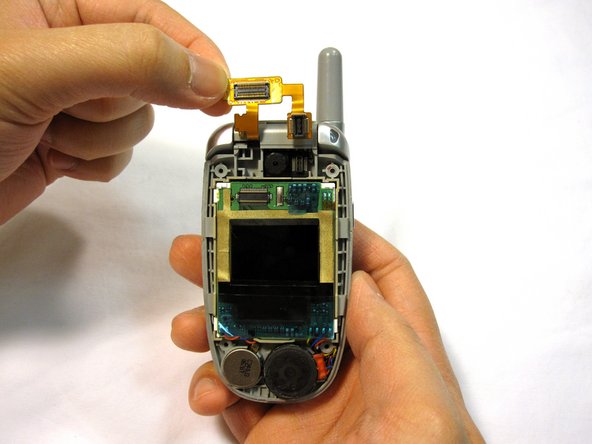

  8. LG VX5200 LCD Screen Replacement: crwdns2935265:08crwdnd2935265:01crwdnd2935265:03crwdne2935265:0 LG VX5200 LCD Screen Replacement: crwdns2935265:08crwdnd2935265:02crwdnd2935265:03crwdne2935265:0 LG VX5200 LCD Screen Replacement: crwdns2935265:08crwdnd2935265:03crwdnd2935265:03crwdne2935265:0
    • Remove the white stopper from the camera light located above the gold connector.
    • Lift the gold connector up with your finger to detach it.

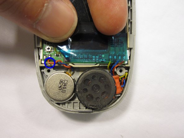

  9. LG VX5200 LCD Screen Replacement: crwdns2935265:09crwdnd2935265:01crwdnd2935265:01crwdne2935265:0
    • Gently lift out the speaker with your fingertip.

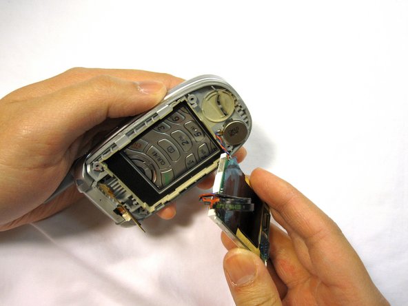

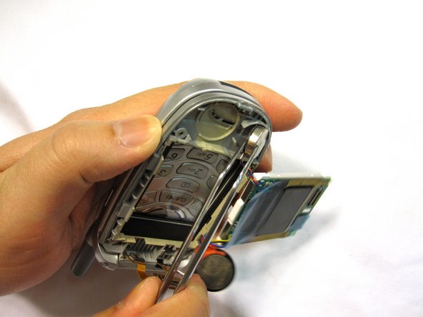

  10. LG VX5200 LCD Screen Replacement: crwdns2935265:010crwdnd2935265:01crwdnd2935265:03crwdne2935265:0 LG VX5200 LCD Screen Replacement: crwdns2935265:010crwdnd2935265:02crwdnd2935265:03crwdne2935265:0 LG VX5200 LCD Screen Replacement: crwdns2935265:010crwdnd2935265:03crwdnd2935265:03crwdne2935265:0

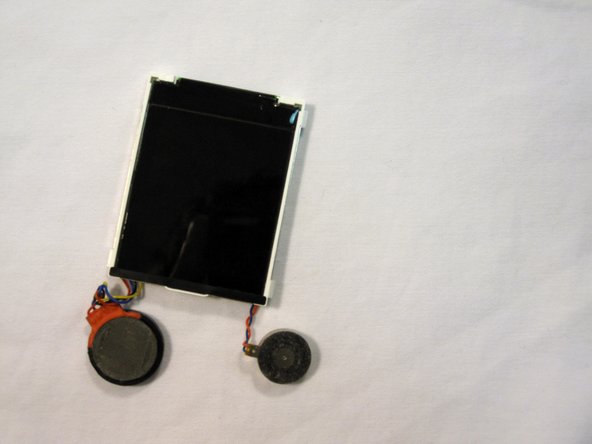

    • Gently lift out the square LCD assembly being careful with the attached vibrator wires.
    • Gently remove the vibrator with tweezers.
    • The LCD screen, speaker and vibrator will separate from the phone as a single unit.
  11. LG VX5200 LCD Screen Replacement: crwdns2935265:011crwdnd2935265:01crwdnd2935265:02crwdne2935265:0 LG VX5200 LCD Screen Replacement: crwdns2935265:011crwdnd2935265:02crwdnd2935265:02crwdne2935265:0
    • Place phone body and LCD screen on a clean, lint-free surface.
