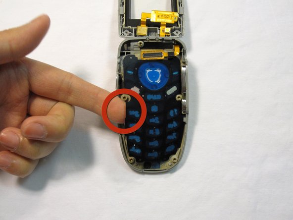

  11. LG VX5200 Keypad Replacement, Keypad: crwdns2935265:011crwdnd2935265:01crwdnd2935265:03crwdne2935265:0 LG VX5200 Keypad Replacement, Keypad: crwdns2935265:011crwdnd2935265:02crwdnd2935265:03crwdne2935265:0 LG VX5200 Keypad Replacement, Keypad: crwdns2935265:011crwdnd2935265:03crwdnd2935265:03crwdne2935265:0
    • Use your finger to lift up the keypad.

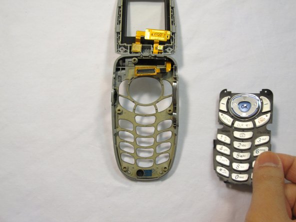

  12. LG VX5200 Keypad Replacement: crwdns2935265:012crwdnd2935265:01crwdnd2935265:01crwdne2935265:0
    • Check to see that your device looks like the image shown.
    • Do not let the buttons fall out of the side casing of the phone!
    • Note: The image is shown with the LCD screen removed. This is not necessary for keypad repair.
