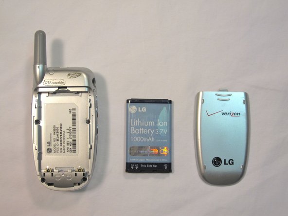

    • Turn the phone on its back.
  2. LG VX5200 Face Plate Replacement: crwdns2935265:02crwdnd2935265:01crwdnd2935265:02crwdne2935265:0 LG VX5200 Face Plate Replacement: crwdns2935265:02crwdnd2935265:02crwdnd2935265:02crwdne2935265:0
    • Orient the phone as shown.
    • Remove the battery cover by pushing upward with your thumb.
  3. LG VX5200 Face Plate Replacement: crwdns2935265:03crwdnd2935265:01crwdnd2935265:02crwdne2935265:0 LG VX5200 Face Plate Replacement: crwdns2935265:03crwdnd2935265:02crwdnd2935265:02crwdne2935265:0
    • Place your fingernail at the top of the battery and pry the battery out towards you.

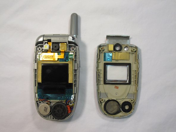

  4. LG VX5200 Face Plate Replacement, Face Plate: crwdns2935265:04crwdnd2935265:01crwdnd2935265:03crwdne2935265:0 LG VX5200 Face Plate Replacement, Face Plate: crwdns2935265:04crwdnd2935265:02crwdnd2935265:03crwdne2935265:0 LG VX5200 Face Plate Replacement, Face Plate: crwdns2935265:04crwdnd2935265:03crwdnd2935265:03crwdne2935265:0
    • Flip the phone open.
    • Remove the four rubber plugs, located at the corners of the LCD screen, with a push-pin.
    • Use a Phillips #00 screwdriver to remove the four screws located underneath the rubber plugs.

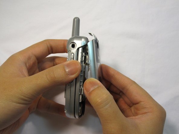

  5. LG VX5200 Face Plate Replacement: crwdns2935265:05crwdnd2935265:01crwdnd2935265:03crwdne2935265:0 LG VX5200 Face Plate Replacement: crwdns2935265:05crwdnd2935265:02crwdnd2935265:03crwdne2935265:0 LG VX5200 Face Plate Replacement: crwdns2935265:05crwdnd2935265:03crwdnd2935265:03crwdne2935265:0
    • Insert the opening tool in the seam of the top portion of the flip phone.
    • Gently pry the seam open.
    • Move the opening tool around the perimeter of the seam and gently take the front LCD face plate out.
  6. LG VX5200 Face Plate Replacement: crwdns2935265:06crwdnd2935265:01crwdnd2935265:03crwdne2935265:0 LG VX5200 Face Plate Replacement: crwdns2935265:06crwdnd2935265:02crwdnd2935265:03crwdne2935265:0 LG VX5200 Face Plate Replacement: crwdns2935265:06crwdnd2935265:03crwdnd2935265:03crwdne2935265:0
    • Close the flip phone.
    • Hold the base of the phone and gently remove the faceplate.
    • Place the phone and the faceplate on a clean, flat surface.
