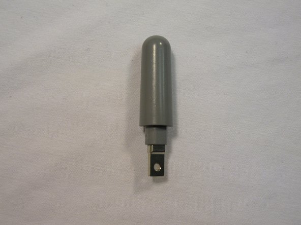

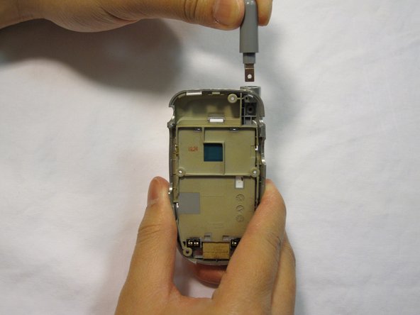

  8. LG VX5200 Antenna Replacement, Antenna: crwdns2935265:08crwdnd2935265:01crwdnd2935265:01crwdne2935265:0
    • Locate the screw and copper fixture that hold the antenna in place.
    • Remove the screw from the device using a Philips #00 screwdriver.
  9. LG VX5200 Antenna Replacement: crwdns2935265:09crwdnd2935265:01crwdnd2935265:02crwdne2935265:0 LG VX5200 Antenna Replacement: crwdns2935265:09crwdnd2935265:02crwdnd2935265:02crwdne2935265:0
    • Remove the copper fixture after it has been unscrewed.
  10. LG VX5200 Antenna Replacement: crwdns2935265:010crwdnd2935265:01crwdnd2935265:02crwdne2935265:0 LG VX5200 Antenna Replacement: crwdns2935265:010crwdnd2935265:02crwdnd2935265:02crwdne2935265:0
    • Check to see that your device looks like the attached photo.
