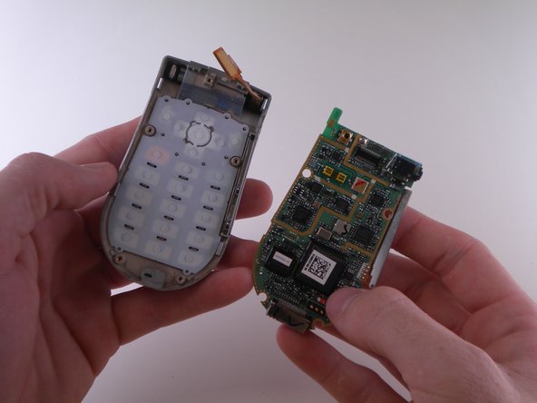

    1. LG VX4500 display interconnect cable, Keypad: crwdns2935265:07crwdnd2935265:01crwdnd2935265:03crwdne2935265:0 LG VX4500 display interconnect cable, Keypad: crwdns2935265:07crwdnd2935265:02crwdnd2935265:03crwdne2935265:0 LG VX4500 display interconnect cable, Keypad: crwdns2935265:07crwdnd2935265:03crwdnd2935265:03crwdne2935265:0
      • Carefully pry and lift up on the logic board using an iPod Opening Tool.
    2. LG VX4500 display interconnect cable: crwdns2935265:08crwdnd2935265:01crwdnd2935265:01crwdne2935265:0
      • Carefully flip the logic board up and out of the way.
    3. LG VX4500 display interconnect cable: crwdns2935265:09crwdnd2935265:01crwdnd2935265:03crwdne2935265:0 LG VX4500 display interconnect cable: crwdns2935265:09crwdnd2935265:02crwdnd2935265:03crwdne2935265:0 LG VX4500 display interconnect cable: crwdns2935265:09crwdnd2935265:03crwdnd2935265:03crwdne2935265:0
      • Use an iPod Opening Tool to lift up on the keypad and pull it out.

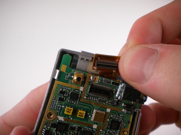

    1. LG VX4500 display interconnect cable, Motherboard: crwdns2935265:010crwdnd2935265:01crwdnd2935265:01crwdne2935265:0
      • DO NOT TOUCH SOLDERING IRON. IT IS EXTREMELY HOT.
      • Use a soldering iron to desolder the solder joint on the front of the motherboard.
      • If you need more information on soldering, refer to this guide.
    2. LG VX4500 display interconnect cable: crwdns2935265:011crwdnd2935265:01crwdnd2935265:01crwdne2935265:0
      • Desolder the joint on the back using a soldering iron.
    3. LG VX4500 display interconnect cable: crwdns2935265:012crwdnd2935265:01crwdnd2935265:03crwdne2935265:0 LG VX4500 display interconnect cable: crwdns2935265:012crwdnd2935265:02crwdnd2935265:03crwdne2935265:0 LG VX4500 display interconnect cable: crwdns2935265:012crwdnd2935265:03crwdnd2935265:03crwdne2935265:0
      • Carefully detach the ribbon cable and remove the motherboard.

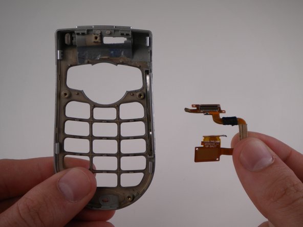

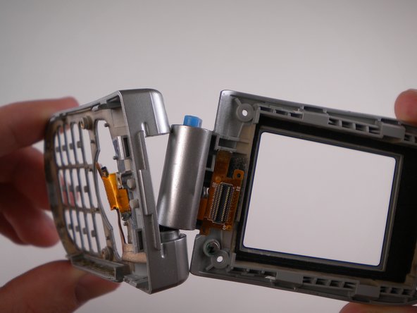

    1. LG VX4500 display interconnect cable, Ribbon Cable: crwdns2935265:021crwdnd2935265:01crwdnd2935265:03crwdne2935265:0 LG VX4500 display interconnect cable, Ribbon Cable: crwdns2935265:021crwdnd2935265:02crwdnd2935265:03crwdne2935265:0 LG VX4500 display interconnect cable, Ribbon Cable: crwdns2935265:021crwdnd2935265:03crwdnd2935265:03crwdne2935265:0

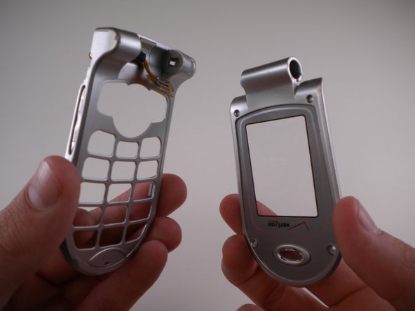

      • Turn phone so that the back side is facing you.
      • Press blue button and remove top half using Spudger.
    2. LG VX4500 display interconnect cable: crwdns2935265:022crwdnd2935265:01crwdnd2935265:02crwdne2935265:0 LG VX4500 display interconnect cable: crwdns2935265:022crwdnd2935265:02crwdnd2935265:02crwdne2935265:0
      • Remove cable from bottom section.
