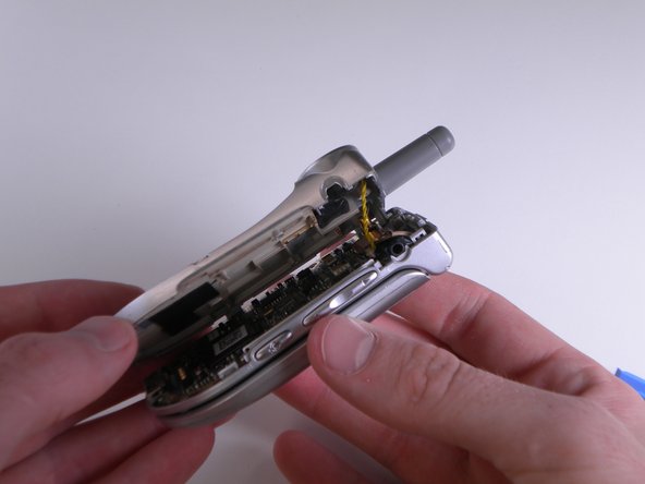

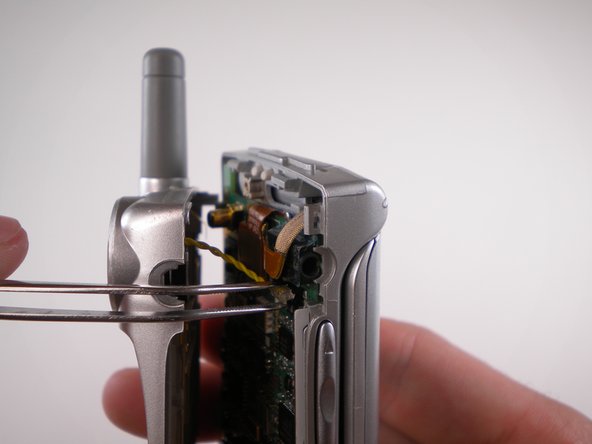

    3. LG VX4500 Keypad Replacement: crwdns2935265:05crwdnd2935265:01crwdnd2935265:03crwdne2935265:0 LG VX4500 Keypad Replacement: crwdns2935265:05crwdnd2935265:02crwdnd2935265:03crwdne2935265:0 LG VX4500 Keypad Replacement: crwdns2935265:05crwdnd2935265:03crwdnd2935265:03crwdne2935265:0
      • When removing back cover, be careful not to break the speaker wires.
      • Using an Opening Tool, carefully pry off the back cover.
      • Using tweezers, gently pull the speaker wires out.
    4. LG VX4500 Keypad Replacement: crwdns2935265:06crwdnd2935265:01crwdnd2935265:01crwdne2935265:0
      • Separate the two halves.

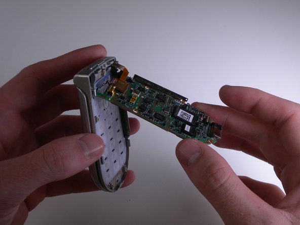

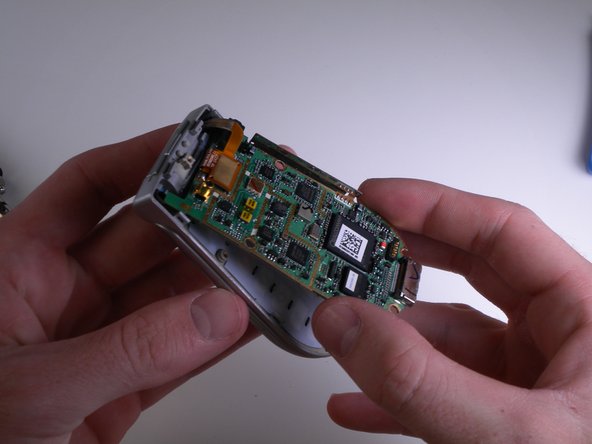

    1. LG VX4500 Keypad Replacement, Keypad: crwdns2935265:07crwdnd2935265:01crwdnd2935265:03crwdne2935265:0 LG VX4500 Keypad Replacement, Keypad: crwdns2935265:07crwdnd2935265:02crwdnd2935265:03crwdne2935265:0 LG VX4500 Keypad Replacement, Keypad: crwdns2935265:07crwdnd2935265:03crwdnd2935265:03crwdne2935265:0
      • Carefully pry and lift up on the logic board using an iPod Opening Tool.
    2. LG VX4500 Keypad Replacement: crwdns2935265:08crwdnd2935265:01crwdnd2935265:01crwdne2935265:0
      • Carefully flip the logic board up and out of the way.

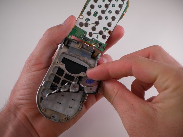

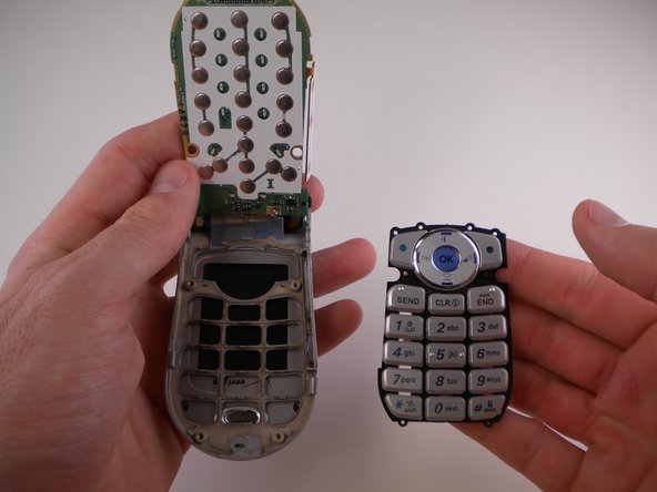

    3. LG VX4500 Keypad Replacement: crwdns2935265:09crwdnd2935265:01crwdnd2935265:03crwdne2935265:0 LG VX4500 Keypad Replacement: crwdns2935265:09crwdnd2935265:02crwdnd2935265:03crwdne2935265:0 LG VX4500 Keypad Replacement: crwdns2935265:09crwdnd2935265:03crwdnd2935265:03crwdne2935265:0
      • Use an iPod Opening Tool to lift up on the keypad and pull it out.
