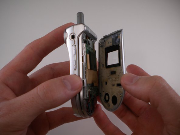

    1. LG VX4500 Display Screen Replacement, Outer Display Cover: crwdns2935265:03crwdnd2935265:01crwdnd2935265:01crwdne2935265:0
      • Remove 4 rubber grommets using the Spudger.
    2. LG VX4500 Display Screen Replacement: crwdns2935265:04crwdnd2935265:01crwdnd2935265:01crwdne2935265:0
      • Remove 4 screws using the Phillips #00 Screwdriver.

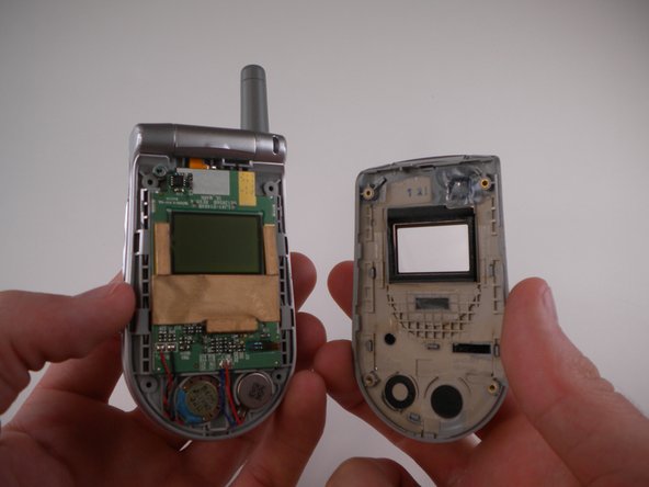

    3. LG VX4500 Display Screen Replacement: crwdns2935265:05crwdnd2935265:01crwdnd2935265:03crwdne2935265:0 LG VX4500 Display Screen Replacement: crwdns2935265:05crwdnd2935265:02crwdnd2935265:03crwdne2935265:0 LG VX4500 Display Screen Replacement: crwdns2935265:05crwdnd2935265:03crwdnd2935265:03crwdne2935265:0
      • Carefully pry off outer cover using iPod Opening Tool.

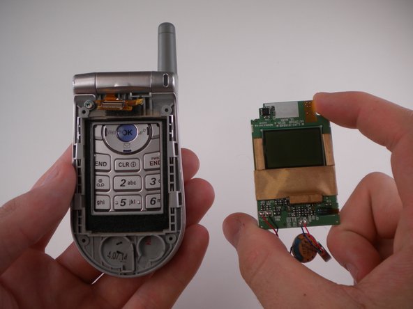

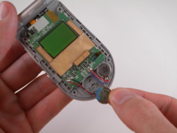

    1. LG VX4500 Display Screen Replacement, Display: crwdns2935265:06crwdnd2935265:01crwdnd2935265:02crwdne2935265:0 LG VX4500 Display Screen Replacement, Display: crwdns2935265:06crwdnd2935265:02crwdnd2935265:02crwdne2935265:0
      • Remove speaker using the Spudger.

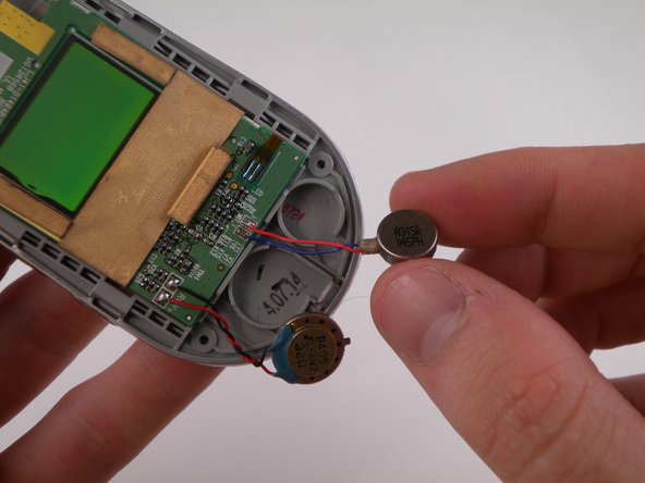

    2. LG VX4500 Display Screen Replacement: crwdns2935265:07crwdnd2935265:01crwdnd2935265:02crwdne2935265:0 LG VX4500 Display Screen Replacement: crwdns2935265:07crwdnd2935265:02crwdnd2935265:02crwdne2935265:0
      • Remove vibrator using the Spudger.

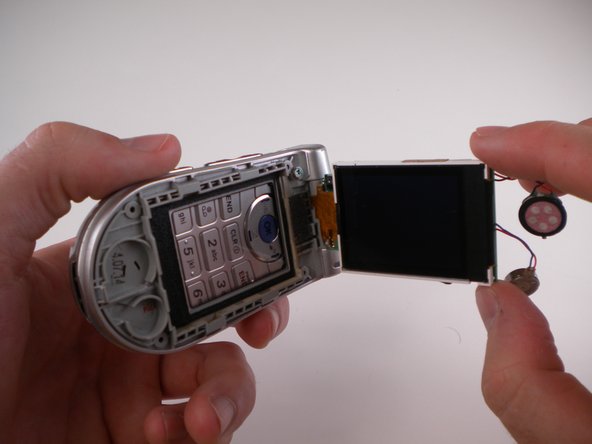

    3. LG VX4500 Display Screen Replacement: crwdns2935265:08crwdnd2935265:01crwdnd2935265:02crwdne2935265:0 LG VX4500 Display Screen Replacement: crwdns2935265:08crwdnd2935265:02crwdnd2935265:02crwdne2935265:0
      • Lift up LCD display using iPod Opening Tool.
    4. LG VX4500 Display Screen Replacement: crwdns2935265:09crwdnd2935265:01crwdnd2935265:01crwdne2935265:0
      • DO NOT TOUCH THE SOLDERING IRON. IT IS EXTREMELY HOT!
      • De-solder solder joint using Soldering Iron.
    5. LG VX4500 Display Screen Replacement: crwdns2935265:010crwdnd2935265:01crwdnd2935265:02crwdne2935265:0 LG VX4500 Display Screen Replacement: crwdns2935265:010crwdnd2935265:02crwdnd2935265:02crwdne2935265:0
      • Pry off ribbon cable using iPod Opening Tool.
