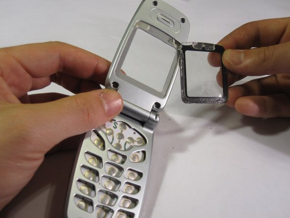

    • Remove the four rubber stoppers around the main screen using the pointed end of the spudger.
  2. LG VX4400 Screen Replacement: crwdns2935265:02crwdnd2935265:01crwdnd2935265:01crwdne2935265:0
    • Use the Phillips #00 screwdriver to remove the four screws that were under the rubber stoppers.
  3. LG VX4400 Screen Replacement: crwdns2935265:03crwdnd2935265:01crwdnd2935265:03crwdne2935265:0 LG VX4400 Screen Replacement: crwdns2935265:03crwdnd2935265:02crwdnd2935265:03crwdne2935265:0 LG VX4400 Screen Replacement: crwdns2935265:03crwdnd2935265:03crwdnd2935265:03crwdne2935265:0

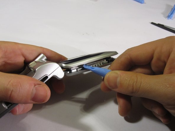

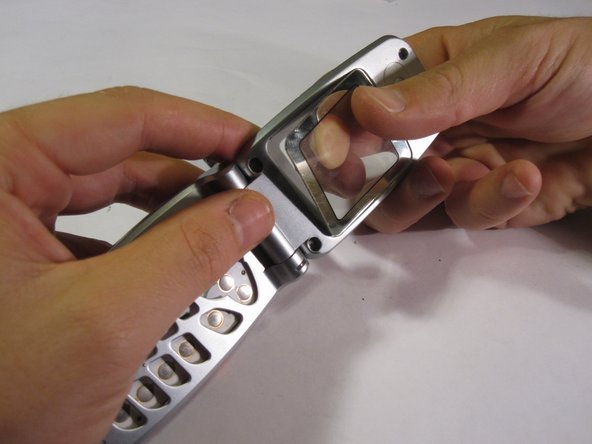

    • Use a plastic opening tool to pry the top end of the phone open.
    • Use a second plastic opening tool to slide down the gap and pry open the case while prying the top panel with the first plastic opening tool.
    • Use the same method on the opposite side of the phone.
  4. LG VX4400 Screen Replacement: crwdns2935265:04crwdnd2935265:01crwdnd2935265:02crwdne2935265:0 LG VX4400 Screen Replacement: crwdns2935265:04crwdnd2935265:02crwdnd2935265:02crwdne2935265:0

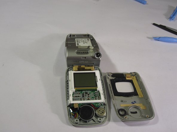

    • Remove plastic screen panel to reveal the internal components.
  5. LG VX4400 Screen Replacement: crwdns2935265:05crwdnd2935265:01crwdnd2935265:03crwdne2935265:0 LG VX4400 Screen Replacement: crwdns2935265:05crwdnd2935265:02crwdnd2935265:03crwdne2935265:0 LG VX4400 Screen Replacement: crwdns2935265:05crwdnd2935265:03crwdnd2935265:03crwdne2935265:0

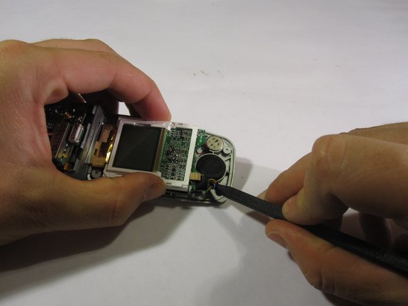

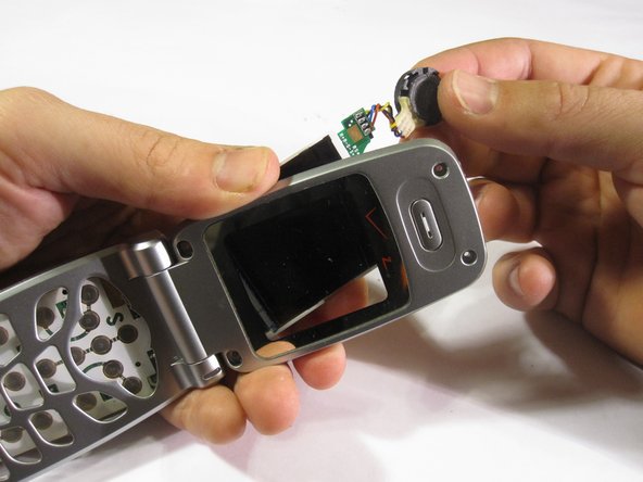

    • Remove the screen board by lifting it away from the phone.
    • Remove the speaker by prying with the spudger.
  6. LG VX4400 Screen Replacement: crwdns2935265:06crwdnd2935265:01crwdnd2935265:03crwdne2935265:0 LG VX4400 Screen Replacement: crwdns2935265:06crwdnd2935265:02crwdnd2935265:03crwdne2935265:0 LG VX4400 Screen Replacement: crwdns2935265:06crwdnd2935265:03crwdnd2935265:03crwdne2935265:0

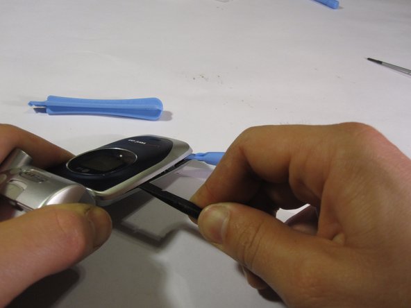

    • Press out the plastic screen gently.
