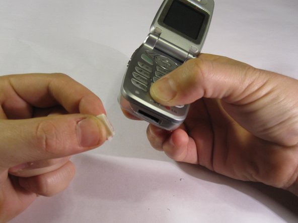

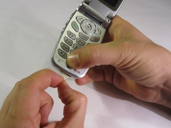

    • The phone may have a rubber insert in the bottom of the phone (see picture). If this rubber insert exists, remove it from the bottom of phone and set aside.

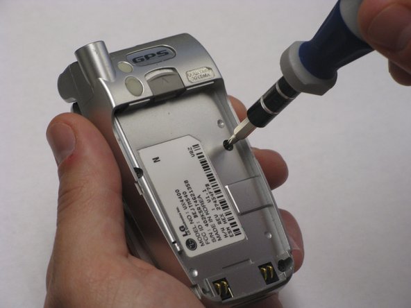

    • Use a Torx T6 screwdriver to unscrew the four screws on the back of the phone.
    • The bit size is engraved on the base of the bit head.

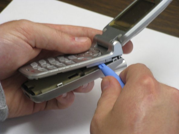

    • With the phone flipped open, wedge the back cover from the faceplate by running the tip of the plastic opening tool around the seam on the back of the phone.
    • Gently pull the two pieces apart to separate, and set the back casing aside.
    • Apply enough force to separate the pieces without cracking the back cover.

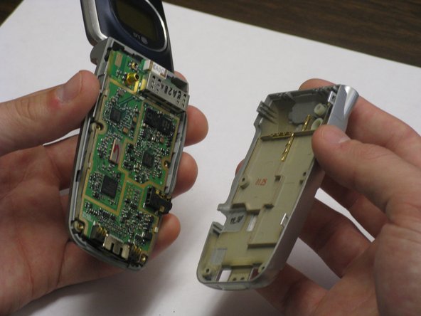

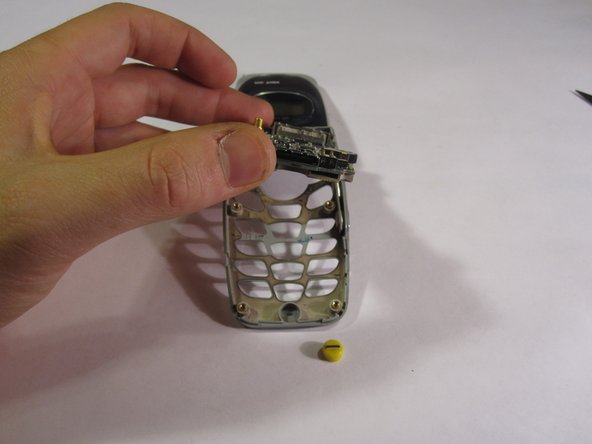

  6. LG VX4400 Microphone Replacement: crwdns2935265:06crwdnd2935265:01crwdnd2935265:01crwdne2935265:0
    • Lift the motherboard to gain access to the keypad and side buttons beneath.
    • The motherboard is attached with a thin ribbon cable at the upper right corner of the case. Be careful not to break the cable.
  7. LG VX4400 Microphone Replacement, Microphone: crwdns2935265:07crwdnd2935265:01crwdnd2935265:03crwdne2935265:0 LG VX4400 Microphone Replacement, Microphone: crwdns2935265:07crwdnd2935265:02crwdnd2935265:03crwdne2935265:0 LG VX4400 Microphone Replacement, Microphone: crwdns2935265:07crwdnd2935265:03crwdnd2935265:03crwdne2935265:0

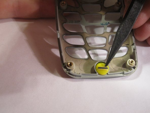

    • Using your fingers or the pointed end of a black plastic spudger, pry the microphone out and replace.
