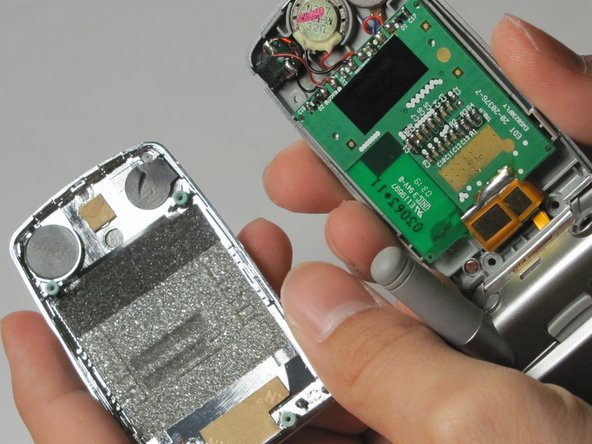

  4. LG VX3100 Speaker Replacement: crwdns2935265:04crwdnd2935265:01crwdnd2935265:01crwdne2935265:0
    • Remove the speaker using the sharp end of the spudger. Removing the speaker may require more effort if the speaker is stuck to the phone.
    • Notice that the speaker and the logic board for the screen are connected by a red and black wire. This will be important for the next step.

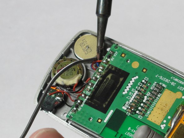

  5. LG VX3100 Speaker Replacement: crwdns2935265:05crwdnd2935265:01crwdnd2935265:02crwdne2935265:0 LG VX3100 Speaker Replacement: crwdns2935265:05crwdnd2935265:02crwdnd2935265:02crwdne2935265:0
    • This step will require soldering experience.
    • Desolder the connection between the logic board screen and the black wire.
    • Desolder the connection between the logic board screen and the red wire.
