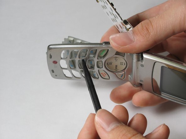

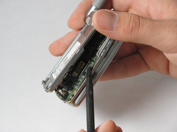

    • Be careful when removing the casing as the spudger can damage the plastic cover of the phone.

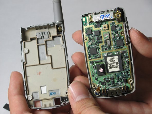

    • Use the spudger to carefully pry around the sides of the plastic casing and remove the back side of the phone.
  4. LG VX3100 Keypad Replacement: crwdns2935265:04crwdnd2935265:01crwdnd2935265:03crwdne2935265:0 LG VX3100 Keypad Replacement: crwdns2935265:04crwdnd2935265:02crwdnd2935265:03crwdne2935265:0 LG VX3100 Keypad Replacement: crwdns2935265:04crwdnd2935265:03crwdnd2935265:03crwdne2935265:0

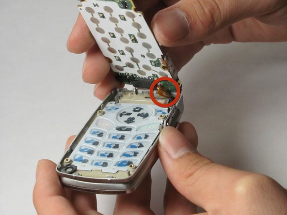

    • Use the spudger to remove the back side of the phone.
    • The logic board is still connected to the rest of the phone with a gold strip; be careful when removing the board.
    • Use the spudger to gently push the keypad out from the other side of the phone.
