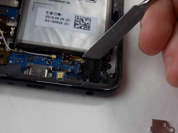

    • Pull up from the right of the metallic cover piece inside of the bottom right of the phone.
    • Remove the metallic piece's base from the board.
    • Make the cubic piece moveable by wiggling under it with an opening pick or spudger.

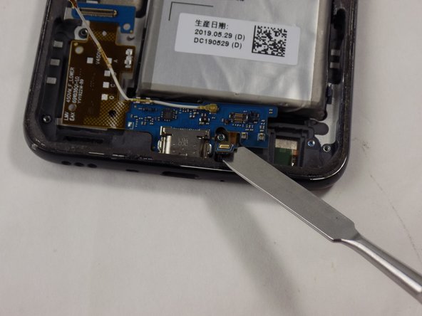

  7. LG V50 ThinQ Speaker & Charging Port Replacement: crwdns2935265:07crwdnd2935265:01crwdnd2935265:01crwdne2935265:0
    • Remove bottom circuiting, the speaker system is a part of the bottom circuit board.
