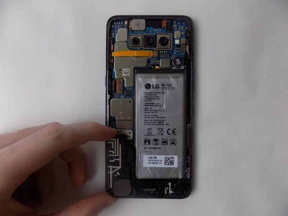

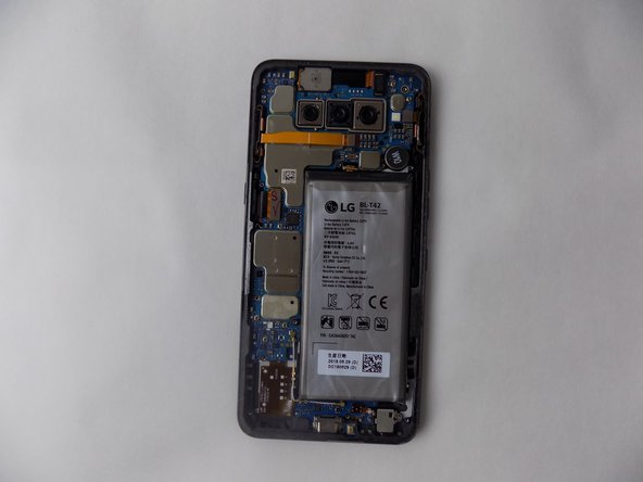

    • Remove the two brackets covering the internal components.

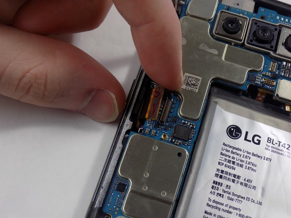

    • Remove the battery connection from its connector port, located above the battery.
    • Similarly, remove the screen connection from its connector port, found on the left side of the back of the device.
