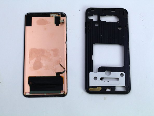

  11. LG V30 Plus Display Assembly Replacement, Display Assembly: crwdns2935265:011crwdnd2935265:01crwdnd2935265:01crwdne2935265:0
    • Pull the ribbon cable attached to the screen away from the board and make sure it is bent upwards and out of the way.
  12. LG V30 Plus Display Assembly Replacement: crwdns2935265:012crwdnd2935265:01crwdnd2935265:01crwdne2935265:0
    • Warm up a pair of iOpeners in the microwave for 1-2 minutes.
    • Place the iOpeners on the edges of the phone and wait a couple of minutes for it to heat up the adhesive.
    • A heat gun may be necessary to heat the adhesive if the screen refuses to separate in the next step.

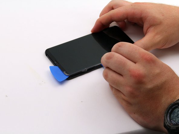

  13. LG V30 Plus Display Assembly Replacement: crwdns2935265:013crwdnd2935265:01crwdnd2935265:03crwdne2935265:0 LG V30 Plus Display Assembly Replacement: crwdns2935265:013crwdnd2935265:02crwdnd2935265:03crwdne2935265:0 LG V30 Plus Display Assembly Replacement: crwdns2935265:013crwdnd2935265:03crwdnd2935265:03crwdne2935265:0
    • Insert an Opening Tool between the metal sides of the phone and the front glass.
    • Slide the Opening Tool around the display, placing Opening Picks as necessary.
    • Use a Suction Handle or hand to remove the screen from the body of the phone.
