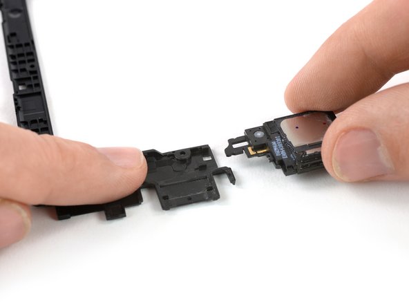

    • The top and bottom frame section hold very tight to the mid frame. It is possible to pull them off with your hands. If you're not able to do so, use the following removal procedure:
    • Use the flat end of a spudger and apply pressure to one of the corners of the frame section until you create a small gap.
  4. LG V20 Loudspeaker Replacement: crwdns2935265:04crwdnd2935265:01crwdnd2935265:02crwdne2935265:0 LG V20 Loudspeaker Replacement: crwdns2935265:04crwdnd2935265:02crwdnd2935265:02crwdne2935265:0
    • Flip the phone and insert an opening pick in the gap you created.
    • Slide the opening pick along the gap until the frame section pops out of its plastic clamps.
  5. LG V20 Loudspeaker Replacement: crwdns2935265:05crwdnd2935265:01crwdnd2935265:01crwdne2935265:0
    • Remove the frame section.
    • Repeat this procedure with the frame section on the other end of the phone.
    • Within the top frame section there's a small silver grating that covers the speaker. This may fall out, so be careful not to lose it.
  6. LG V20 Loudspeaker Replacement: crwdns2935265:06crwdnd2935265:01crwdnd2935265:02crwdne2935265:0 LG V20 Loudspeaker Replacement: crwdns2935265:06crwdnd2935265:02crwdnd2935265:02crwdne2935265:0
    • The loudspeaker is attached to the cover of the motherboard. Use an opening pick to pry it up.
  7. LG V20 Loudspeaker Replacement: crwdns2935265:07crwdnd2935265:01crwdnd2935265:02crwdne2935265:0 LG V20 Loudspeaker Replacement: crwdns2935265:07crwdnd2935265:02crwdnd2935265:02crwdne2935265:0
    • The cover of the motherboard is held in its place by several plastic clamps.
    • Use an opening pick to pry up the motherboard cover at the right corner at the bottom of your phone until it pops out of the plastic clamp.
  8. LG V20 Loudspeaker Replacement: crwdns2935265:08crwdnd2935265:01crwdnd2935265:02crwdne2935265:0 LG V20 Loudspeaker Replacement: crwdns2935265:08crwdnd2935265:02crwdnd2935265:02crwdne2935265:0
    • Slide the opening pick along the mid frame and flip it sideways to open the plastic clamps holding the motherboard cover in its place.
  9. LG V20 Loudspeaker Replacement: crwdns2935265:09crwdnd2935265:01crwdnd2935265:01crwdne2935265:0
    • Remove the motherboard cover.
  10. LG V20 Loudspeaker Replacement, Loudspeaker: crwdns2935265:010crwdnd2935265:01crwdnd2935265:02crwdne2935265:0 LG V20 Loudspeaker Replacement, Loudspeaker: crwdns2935265:010crwdnd2935265:02crwdnd2935265:02crwdne2935265:0
    • The loudspeaker is attached to the cover of the motherboard by a tight plastic clamp.
    • Flip the motherboard cover and pull the loudspeaker out of the plastic clamp at the lower end of it. Take care not to break the clamp.

Step 5 isn’t quite right. You can pry the speaker up like that, but you need to pull on the speaker to remove it, not pry it up. Pulling it out is difficult without removing more of the framing. I’d advise extreme caution removing the speaker like they have illustrated without pulling up more of the framing around the outside of the phone first. It’s more screws to deal with, but it’s better than breaking anything.
Cody Billings - crwdns2934203:0crwdne2934203:0
Just completed. New speaker seemed to seed nicely. Upon restarting phone no sound emitting from any speaker. Reinstalled faulty speaker and same results. Reinstalled new speaker and did a reset of factory settings, still no sound emitting from music, notifications, etc. This tutorial suggested straight forward plug and play. Disappointed.
