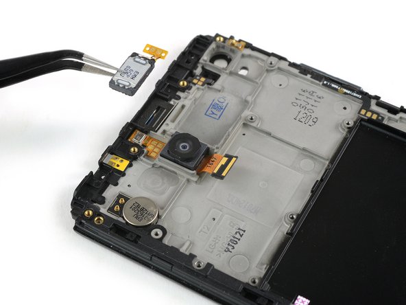

  14. LG V20 Earpiece Speaker Replacement, Earpiece Speaker: crwdns2935265:014crwdnd2935265:01crwdnd2935265:01crwdne2935265:0
    • Use an iOpener to loosen the adhesive beneath the earpiece speaker and its flex cable.
  15. LG V20 Earpiece Speaker Replacement: crwdns2935265:015crwdnd2935265:01crwdnd2935265:02crwdne2935265:0 LG V20 Earpiece Speaker Replacement: crwdns2935265:015crwdnd2935265:02crwdnd2935265:02crwdne2935265:0
    • Use a pair of tweezers to carefully lift the earpiece speaker out of the device and remove it.
    • Take especially care of the small flex cable attached to it.
