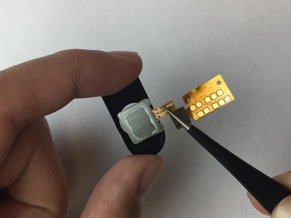

    3. LG V10 Fingerprint Sensor Replacement: crwdns2935265:05crwdnd2935265:01crwdnd2935265:02crwdne2935265:0 LG V10 Fingerprint Sensor Replacement: crwdns2935265:05crwdnd2935265:02crwdnd2935265:02crwdne2935265:0
      • Once removed, the power button/fingerprint sensor component has a plastic layer holding it in place, so use plastic tweezers to pry off this layer.
      • Remove the power button/fingerprint sensor component from its plastic frame with plastic tweezers and replace it with the new one.
      • Apply B-7000 glue on the power button/fingerprint sensor to attach the plastic layer that was removed from the old one.
