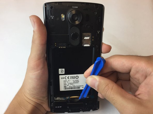

      • Wedge the flat end of the plastic spudger, or the tip of your finger, in between the back cover and the LG V10’s charging port.
      • If using a spudger, it should not be in the charging port, but between the metal lining of the charging port and the back cover.
      • Carefully lift up on the spudger or with your finger so that the back cover pops up. The rest of the back cover should easily come off by sliding a finger or spudger under the back cover and around the sides.

      • Using a screwdriver with a J000 Phillips bit, remove fourteen 3.175 mm screws.
      • Using a plastic opening tool, pry part of the panel up starting from the sides of the battery slot.
      • Use plastic tweezers to release the rest of the panel from plastic bits holding it in place and pry the panel up around the sides surrounding the fingerprint sensor and camera lens.

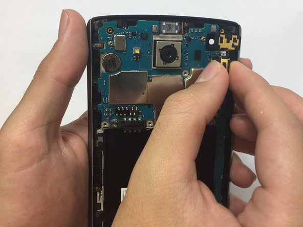

      • Using the flat end of a plastic spudger or a plastic opening tool, wedge it under the front cameras’ motherboard connection and disconnect it.
