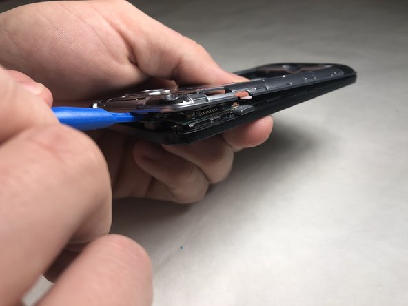

    • Wedge the plastic opening tool into the seam between the plastic backing and the rest of the phone.
  2. LG Ultimate 2 Digitizer Replacement: crwdns2935265:02crwdnd2935265:01crwdnd2935265:01crwdne2935265:0
    • Use your hand to pull the plastic cover completely off of the phone.

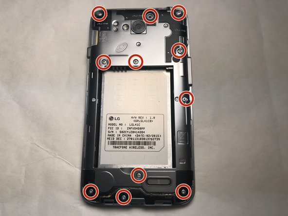

  4. LG Ultimate 2 Digitizer Replacement, Digitizer: crwdns2935265:04crwdnd2935265:01crwdnd2935265:02crwdne2935265:0 LG Ultimate 2 Digitizer Replacement, Digitizer: crwdns2935265:04crwdnd2935265:02crwdnd2935265:02crwdne2935265:0
    • Use a Phillips #0 screwdriver to remove the 11 mid-frame screws.
