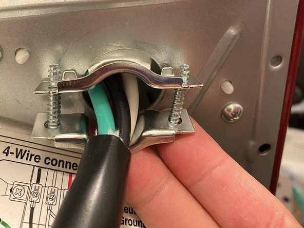

  4. LG TrueSteam  Power Cord Replacement: crwdns2935265:04crwdnd2935265:01crwdnd2935265:01crwdne2935265:0
    • Use the Phillips #0 to loosen the two 6mm screws that secure the clamps holding the wires in place. Simply loosening them and maneuvering them out of the hole will suffice.

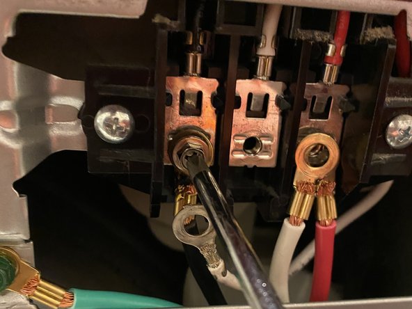

  5. LG TrueSteam  Power Cord Replacement: crwdns2935265:05crwdnd2935265:01crwdnd2935265:03crwdne2935265:0 LG TrueSteam  Power Cord Replacement: crwdns2935265:05crwdnd2935265:02crwdnd2935265:03crwdne2935265:0 LG TrueSteam  Power Cord Replacement: crwdns2935265:05crwdnd2935265:03crwdnd2935265:03crwdne2935265:0
    • Remove the wires connected to the dryer with your Phillips #0 screwdriver, making sure to stay in control of the 2.2mm screws holding them in place.
    • Accidentally dropping them into the dryer will ensure you never see them again.

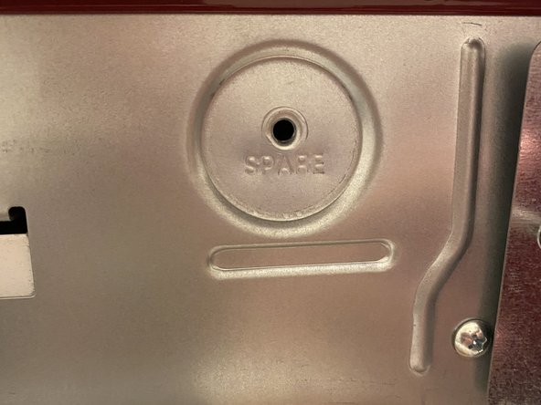

  7. LG TrueSteam  Power Cord Replacement: crwdns2935265:07crwdnd2935265:01crwdnd2935265:02crwdne2935265:0 LG TrueSteam  Power Cord Replacement: crwdns2935265:07crwdnd2935265:02crwdnd2935265:02crwdne2935265:0
    • Notice that the grounding wire screw is a 3.2 mm screw compared to the other ones at 2.2mm. It is important to keep them separated. In the event that you lose a 2.2mm screw, there should be a spare screwed into the back of your dryer.

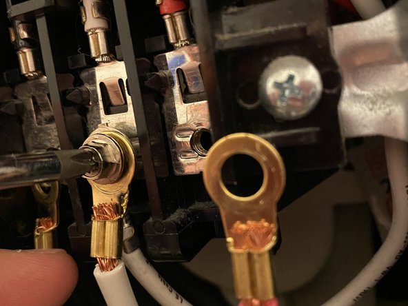

  8. LG TrueSteam  Power Cord Replacement: crwdns2935265:08crwdnd2935265:01crwdnd2935265:03crwdne2935265:0 LG TrueSteam  Power Cord Replacement: crwdns2935265:08crwdnd2935265:02crwdnd2935265:03crwdne2935265:0 LG TrueSteam  Power Cord Replacement: crwdns2935265:08crwdnd2935265:03crwdnd2935265:03crwdne2935265:0
    • Feed the new power cable into the wire hole, and screw the cables in from reverse order using the proper corresponding screws. Note that the white cables are stacked on top of each other. In that case the wire coming from the dryer goes under the wire from the new cord.
  9. LG TrueSteam  Power Cord Replacement: crwdns2935265:09crwdnd2935265:01crwdnd2935265:02crwdne2935265:0 LG TrueSteam  Power Cord Replacement: crwdns2935265:09crwdnd2935265:02crwdnd2935265:02crwdne2935265:0
    • Lastly replace the back panel, and wire clamp. Ensure that the wire clamp hooks into the wire hole. This will keep the wires from falling out and getting damaged.

The spare screw note was a life saver. Didn't even notice that was there and was scrambling to find a replacement before I found this guide.
