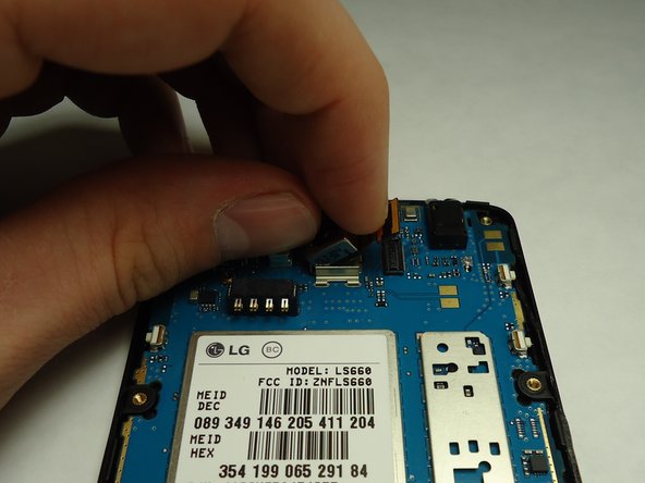

The rear facing camera on the LG Tribute is a fairly simple component to replace. The phone takes only a couple minutes to break down, and the camera can be replaced without any soldering.
    1. LG Tribute Rear-Facing Camera Replacement, Battery: crwdns2935265:01crwdnd2935265:01crwdnd2935265:02crwdne2935265:0 LG Tribute Rear-Facing Camera Replacement, Battery: crwdns2935265:01crwdnd2935265:02crwdnd2935265:02crwdne2935265:0
      • Use the plastic opening tool to pry off the back cover.
    2. LG Tribute Rear-Facing Camera Replacement: crwdns2935265:02crwdnd2935265:01crwdnd2935265:01crwdne2935265:0
      • Lift the battery out of place.
      • When replacing the battery, the (+) and (-) symbols must match up with the phone's charging nodes.
    1. LG Tribute Rear-Facing Camera Replacement, Mid-panel: crwdns2935265:03crwdnd2935265:01crwdnd2935265:02crwdne2935265:0 LG Tribute Rear-Facing Camera Replacement, Mid-panel: crwdns2935265:03crwdnd2935265:02crwdnd2935265:02crwdne2935265:0
      • Remove eight 4mm screws using a Phillips head 000 screwdriver (PH000).
    2. LG Tribute Rear-Facing Camera Replacement: crwdns2935265:04crwdnd2935265:01crwdnd2935265:02crwdne2935265:0 LG Tribute Rear-Facing Camera Replacement: crwdns2935265:04crwdnd2935265:02crwdnd2935265:02crwdne2935265:0
      • Use a plastic opening tool to loosen the tabs around the edge of the phone.
      • Inserting a thin piece of plastic will help prevent opened tabs from locking back into place.
      • This step can be frustrating, but requires patience. Avoid the temptation to pry the panel loose. Using excessive force may break the delicate tabs.
    1. LG Tribute Rear-Facing Camera Replacement, Rear Facing Camera: crwdns2935265:05crwdnd2935265:01crwdnd2935265:02crwdne2935265:0 LG Tribute Rear-Facing Camera Replacement, Rear Facing Camera: crwdns2935265:05crwdnd2935265:02crwdnd2935265:02crwdne2935265:0
      • Disconnect the rear facing camera from the motherboard using a plastic opening tool.
      • Lift the rear facing camera out of its housing.
